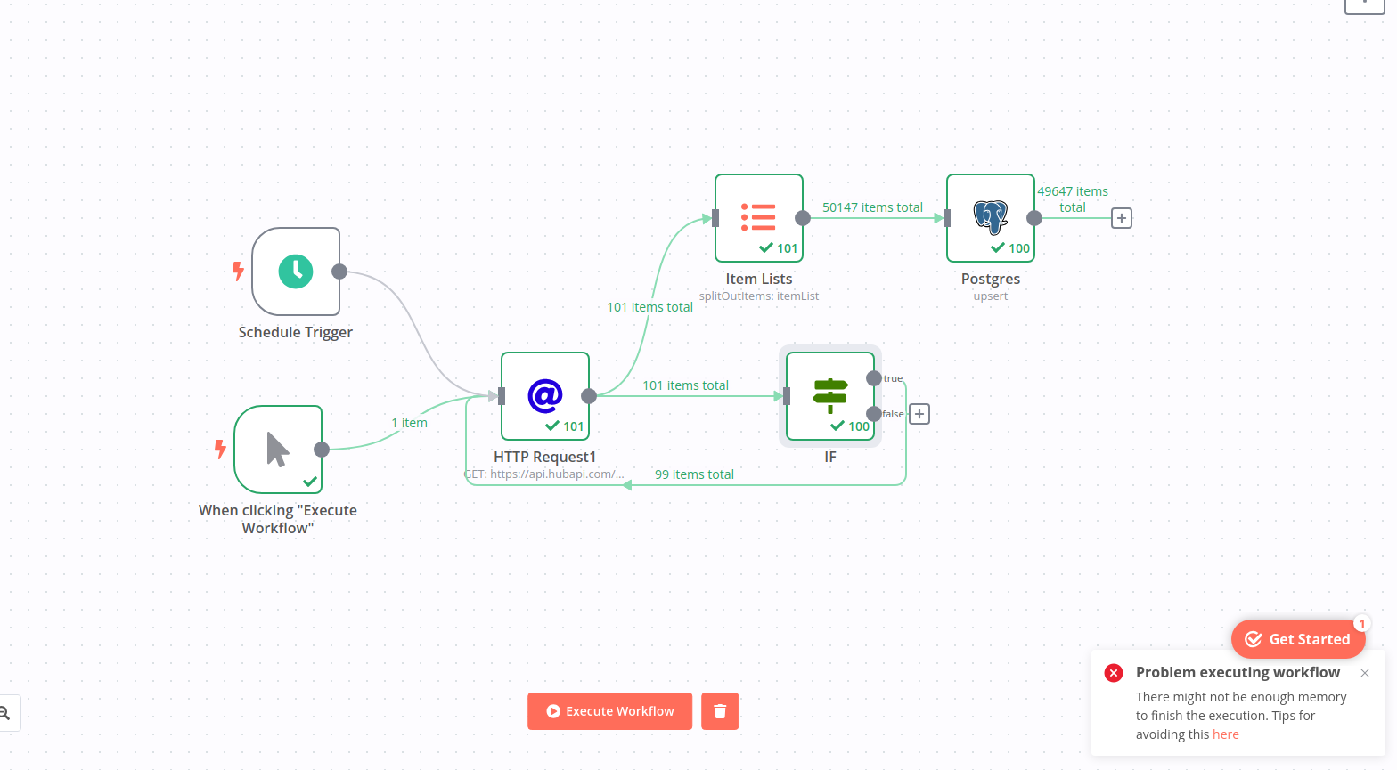

My workflow is failing and I have no clue why.
The job is running, then at some point it “fails”, and all jobs are ticked green.

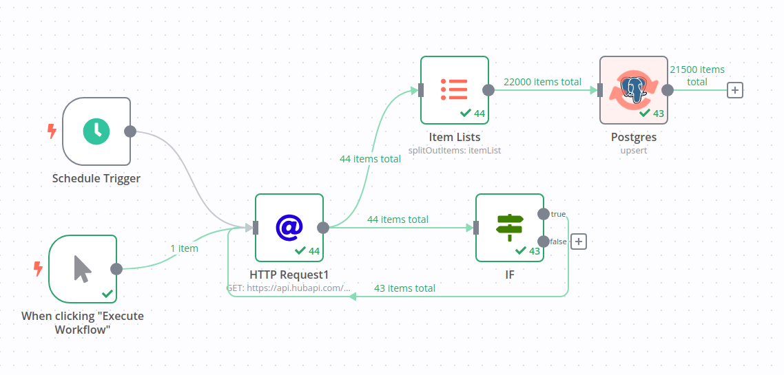

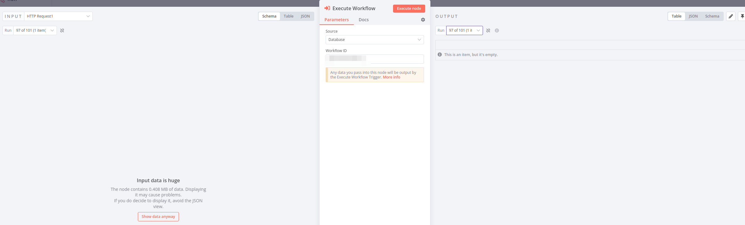

a weird step : i have 44* 1000 contacts, but only “23k inserted” is displayed
after running it manually I actually get this :
It looks like it has run correctly, but there is a memory error on last step.
The memory issue might be because i’m running it manually (so a copy of the data is saved), but again I get an unknown error when I run it automatically (through the scheduler).
Also : the data is correctly split in chunks (according to memory docs, this is what should be done)
There is no error message when I run it through the scheduler, and an “out of memory” error when I run it manually.

Hey @hilnius,
I suspect this is a memory issue, when we talk about splitting it into chunks we tend to also mean making a sub workflow to handle the data so rather than loading 22000 items in one go and making 22000 Postgres calls which would also return the items we would put part of it in a subworkflow so you would handle say 1000 at a time then when the subworkflow finishes the memory is released and the main workflow can do the next loop.
In your example I would put the sub workflow between the HTTP Request node and the If and have that do the Item Lists and Postgres.

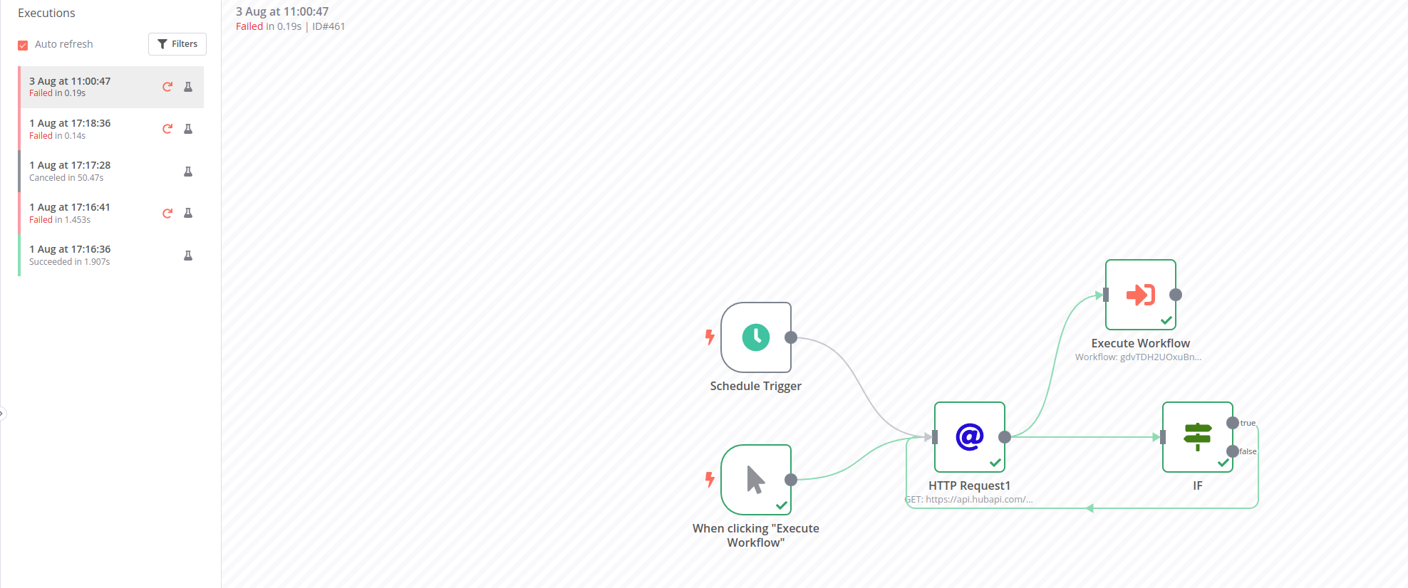

Hello Jon

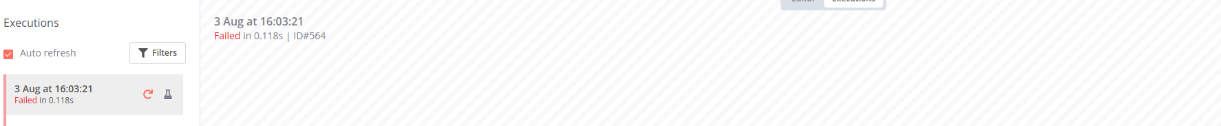

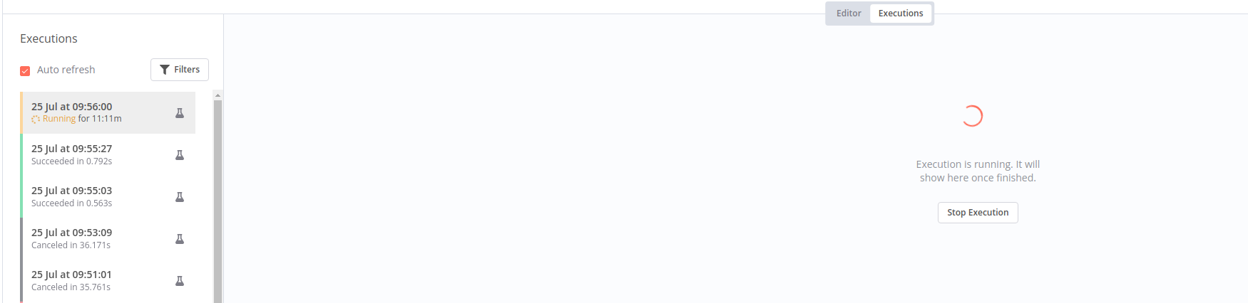

Executing this workflow did work - but the workflow crashed again
All shows green, but the execution panels shows a “failed job”
(by the way there is a problem because the job did take a lot more time than 0.14s).

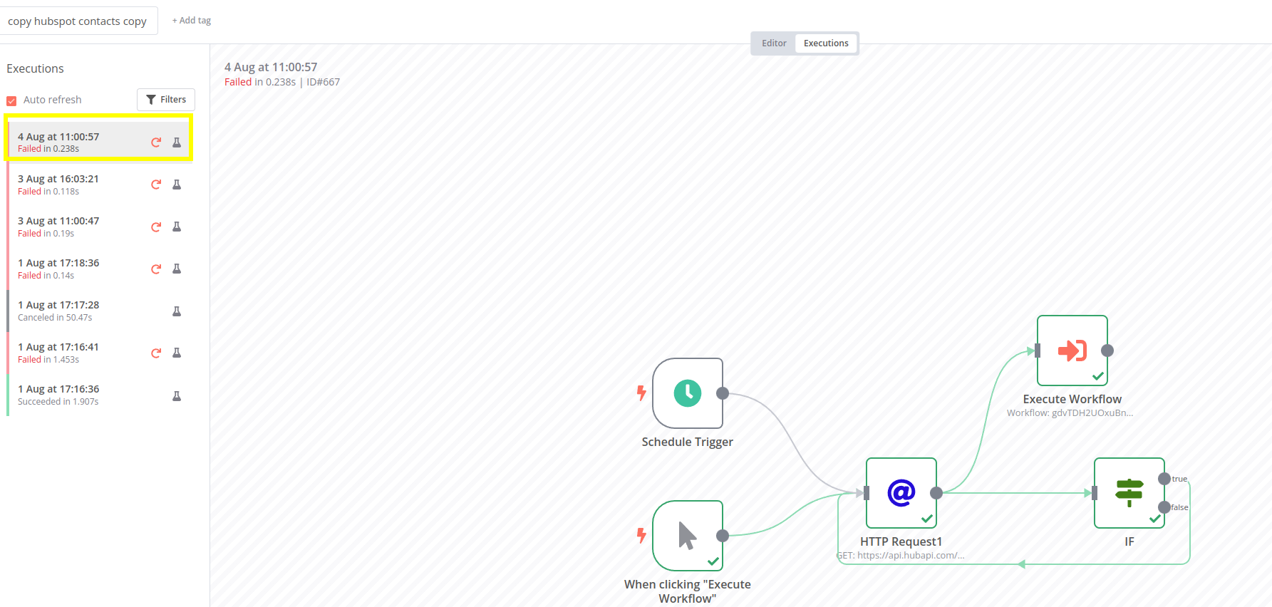

I tried making a recursive workflow but it didn’t work either. The workflow called itself - no problem there, but then executions started failing after they took too much time (because first executions dont “end” until all recursive subworkflows are called).
So I don’t have a solution right now.

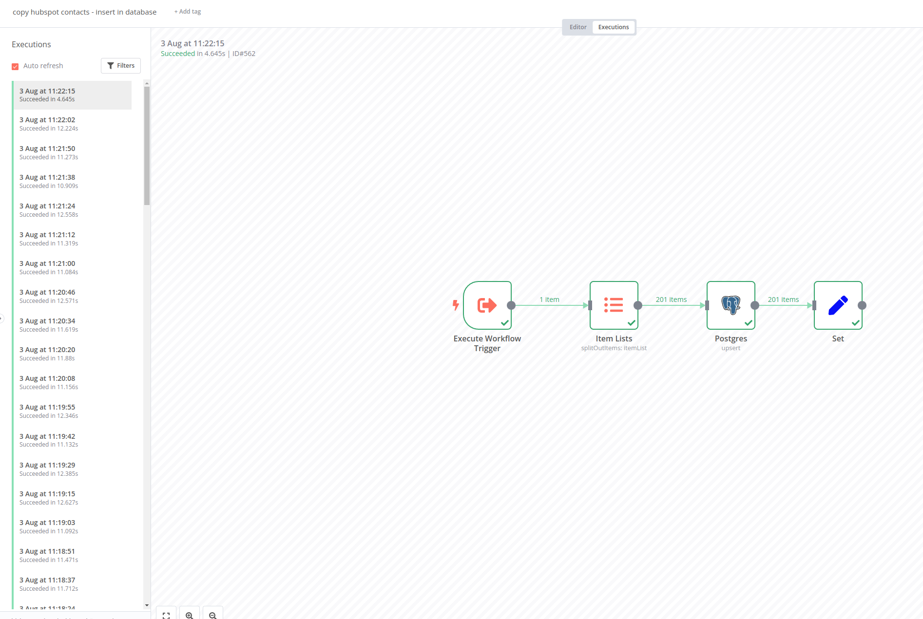

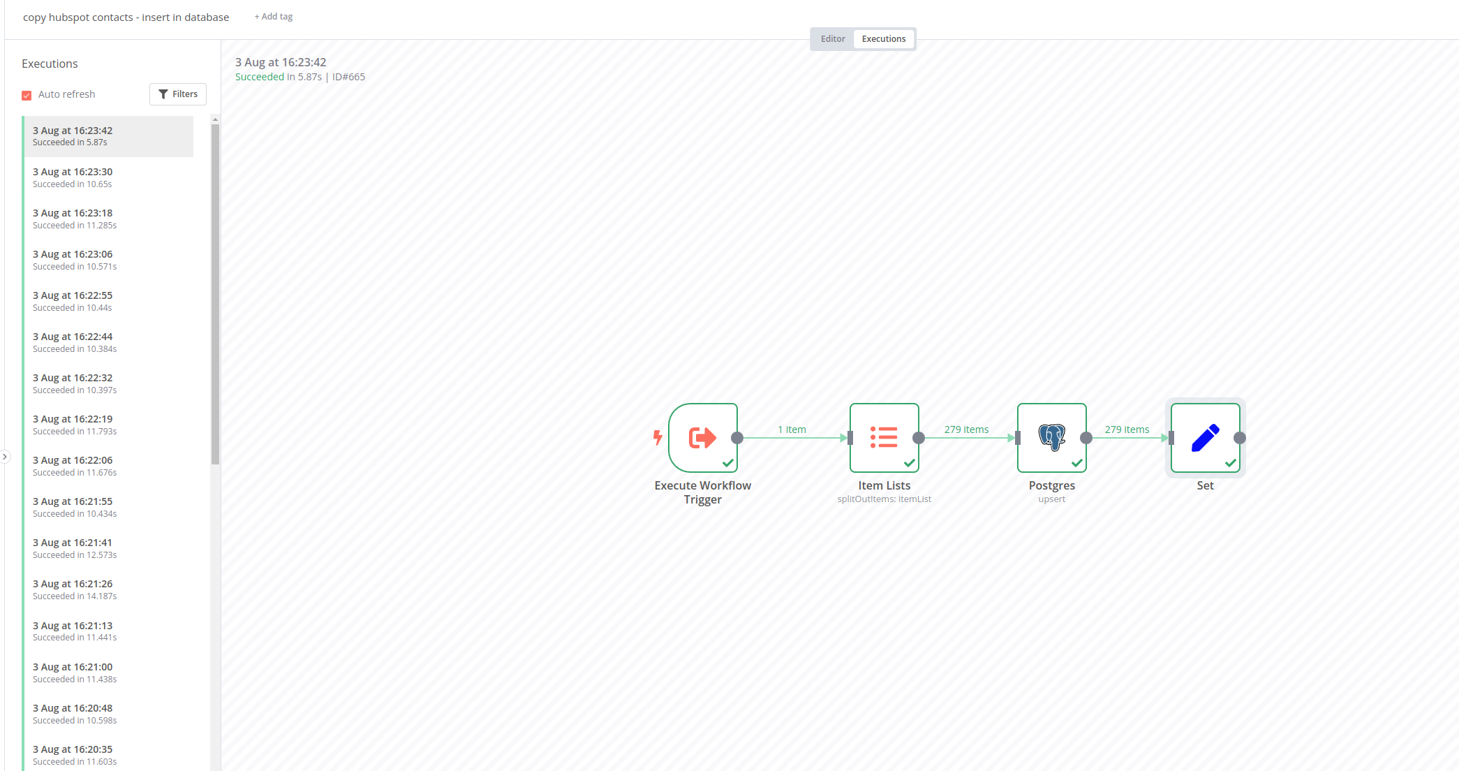

Hi @hilnius
You need to clear the data before returning to the main workflow. you can do this by using a set node set it to keep only set (not setting any fields) and set it to run only once at the settings of the node (the cog icon)
Edit: the last node executed is returning data to the main flow automatically. so just put a set node at the end with the settings I mentioned.
Well, same problem :
the sub-jobs all executed successfully, but the parent job won’t terminate correctly (and i don’t know why it sais “failed”).

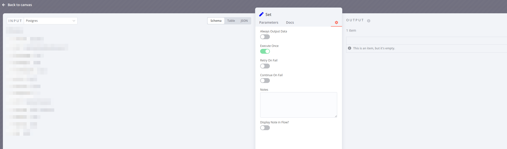

You did not set it to execute only once it seems. Please see if it works with that setting set.
Although with empty items it should still be fine without the setting.
I just tried that (adding “execute once”) to the “set” node at the end of the sub-workflow, but i’m getting the same issue.
I’ve checked the data and the subworkflow does return just one empty row instead of 500

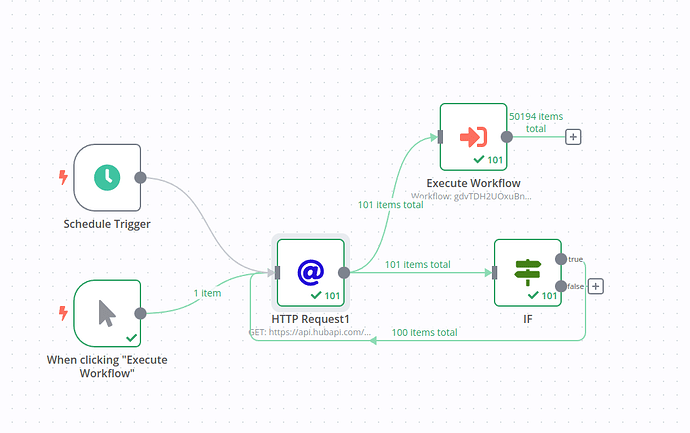

all sub-workflows finish but the parent workflows logs says “execution failed in 0.118s”

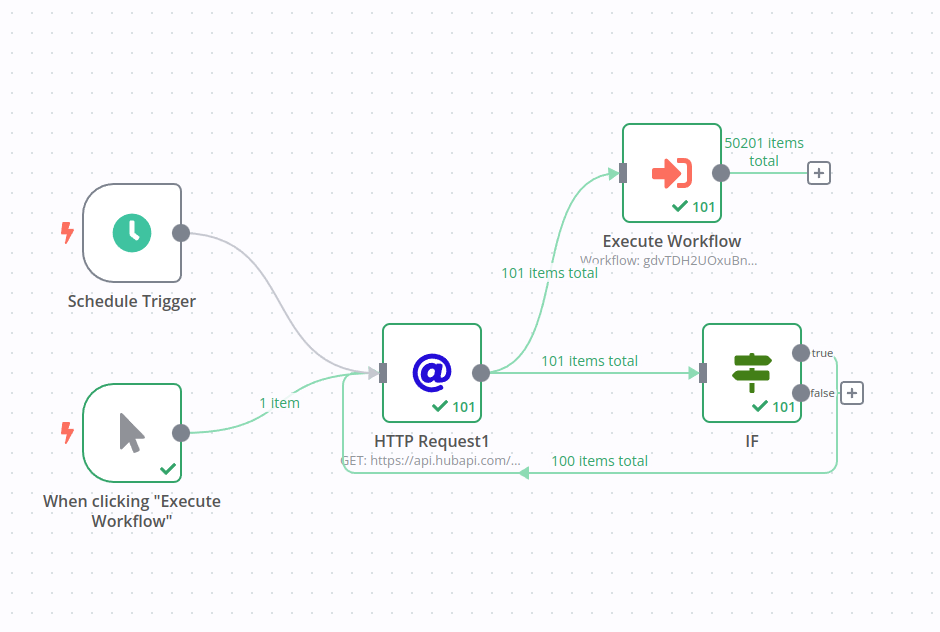

What does the output of the main workflow look like now you have the set node to only run once and I would also add an item like a bool for finished or something so that it moves to the parent workflow, If there is no output item it will just stop.
The parent workflow looks ok
i’ve done it this morning again to show :
the output is correctly passed back to the parent (101 items of just one empty object)
so again the whole workflow seems to be alright (and has terminated correctly) but the status keep saying “failed in 0.2s” - although 1- it succeeded and 2- it lasted a lot longer.
