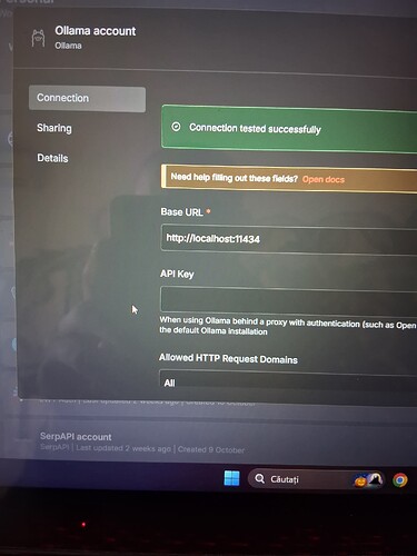

Hey @Aptech and @Ayaan_Rahman !
First of all, how do you start ollama on your localhost?( I do it simply ollama run MY_MODEL )
Then I don’t use any API key since I use it locally.
And in some cases you can use
127.0.0.1:11434 instead localhost:11434 .
