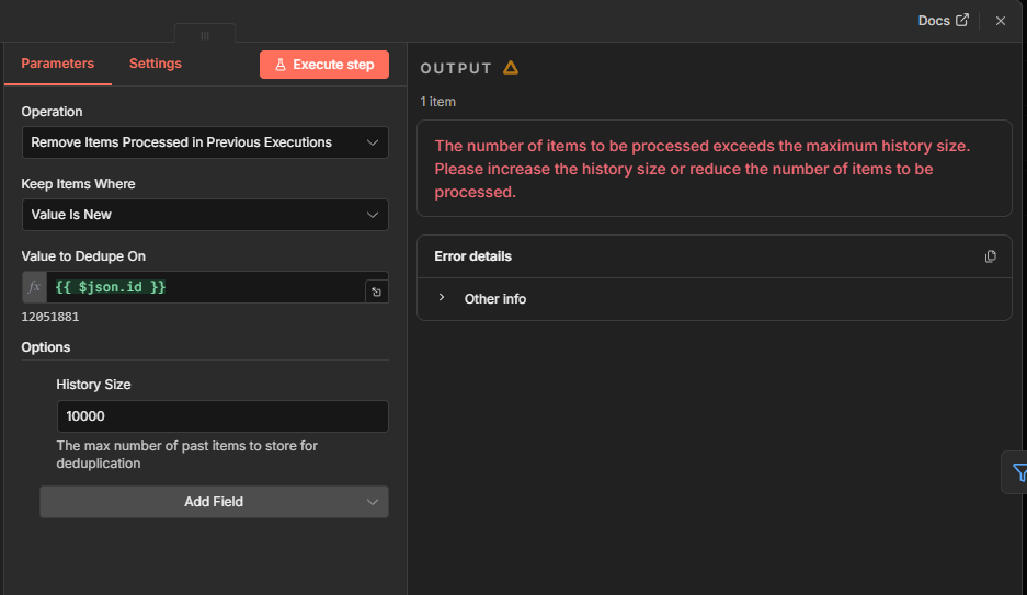

Hi, there, I am using Remove Duplicate Node to filter those duplicate records by a time trigger. Since the source only returen fix number result and there are old records and new records in one batch. So I am using Remove Duplicate Node and set it to "Remove items Processed in Previous Executions" to get new records only.
I use keep items where "value is new" and the value to dedupe on is an ID key.
Default history size is untouched and I assume it's 10000.
It raised error "The number of items to be processed exceeds the maximum history size. Please increase the history size or reduce the number of items to be processed."
My previouse flow is just a http request and get 200 records back.
it’s a simple json file with 200 records.

Same issue here,
I can increase the history size, but what is the point? It will just throw the same error again once it reaches the new size limit,
I’m not sure if this node is designed to work as FIFO (First-In, First-Out) but right now it doesn’t seem reliable :confused:
Any suggestions for an auto-clearing approach with this node would be appreciated..
