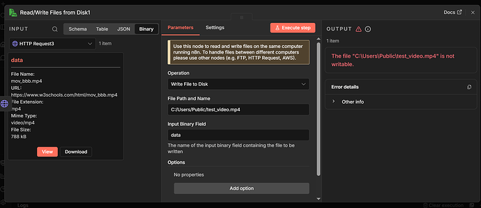

I was trying to download a video from a website… But apparently its giving this error
Any idea on how to fix it?
I tried setting up enviornment variables etc but it wouldn’t work.
Gemini has kinda given up on me
And I dont know what to do, please help.
Thanks

Hi @azizaavon
and Welcome to the Community :waving_hand:
Most likely: You are running n8n inside a container (Docker) which cannot see
your Windows C: drive,
or the N8N_RESTRICT_FILE_ACCESS_TO security setting is active and blocking that folder.
Try:
Change the path to just test_video.mp4 (no folders) to see if it writes to the default allowed directory.
Verify your hosting mode: if using Docker, you must use Linux paths (e.g., /home/node/files/video.mp4) and map a volume to your Windows folder.
Hi @azizaavon! Welcome to the n8n communitty :sparkles:. n8n does not save files automatically, and using responseFormat file alone is not enough. Without defining a Binary Property Name, the downloaded file is not exposed as binary data and becomes invisible to the next node. As a result, the write node tries to save a file that does not exist.
Hi @azizaavon Welcome!
Just remove the filename from the path and keep it something like C:/Users/Public/ and this would make it work just fine!
Yes Thank you it was the set N8N_RESTRICT_FILE_ACCESS_TO=“” setting
