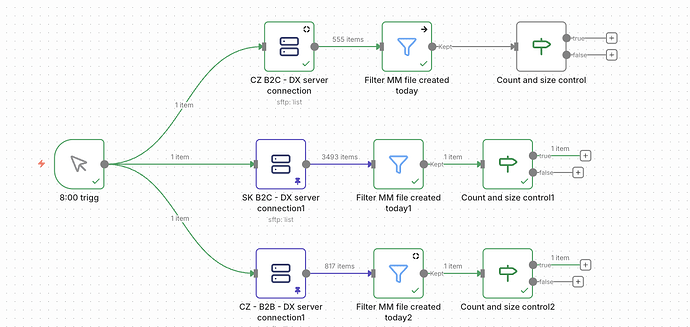

Now it’s even more confusing. If I pin the sample data in the FTP node, the workflow works correctly. Without the pinned data, it doesn’t reach the IF node, even though the FTP node shows that the data was successfully passed.
I am not able to paste the whole worklfow here.

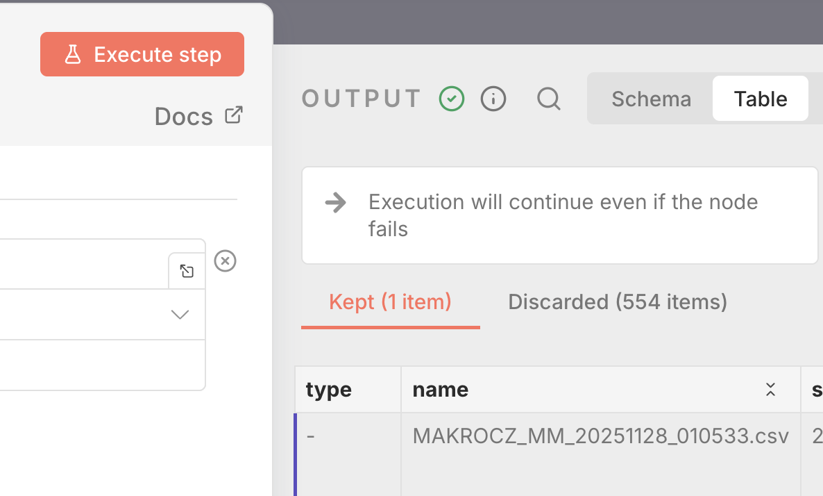

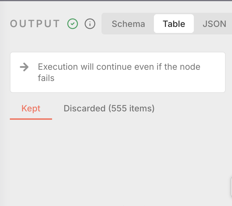

I am getting two different results as you can see in bellow examples.
Automatic execution via start workflow:
Manual execution (Execute step)

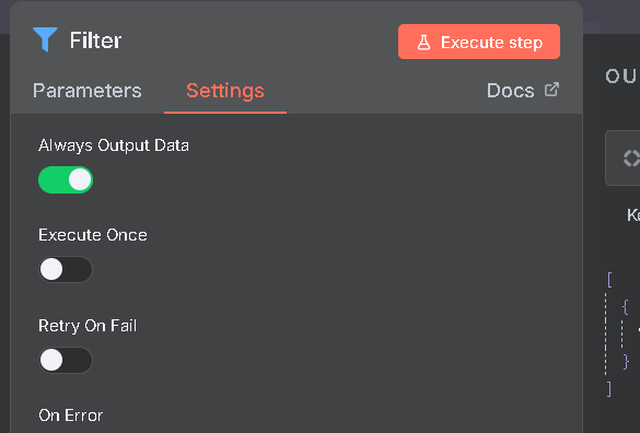

do like this:
this will make filter return empty json and it will make flow continue.
I also tried this setting. The setting ensures that the flow completes its run, but with an incorrect (empty) value.
It is strange that the node returns different values when run manually and automatically.
