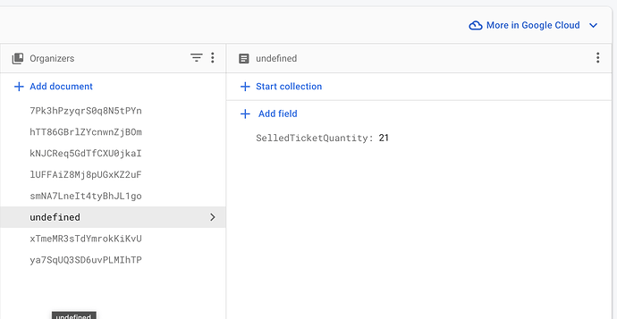

Firebase Document update won't Update, just do an undefined document, even if it exist
Somehow the Firebase Upset Node won’t do what I want, just make an “undefined” document.
Hi @Official_Berry, welcome to the community!
I believe n8n has tricked you here. Some nodes (mostly database and spreadsheet ones) do require the name/key of a field, not the actual value. The name of the key would need to be identical in both your n8n data and in your Firestore collection. You can rename your n8n fields as needed using the Rename Keys node

The result is also visible in the cloud console:

Oh, sooo the Update Key is not the actual vaule, instead of the field name, what comes form the set or whatever node send them… o f… my mistake.
Exactly! And to be fair this isn’t exactly intuitive. If you’re just getting started with n8n you probably would have also seen the data mapping popups showing you how to use the actual values (instead of the field name) :see_no_evil:

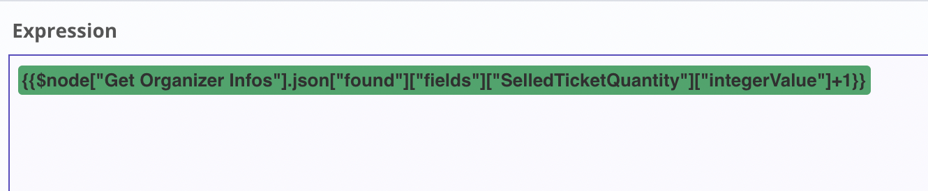

Some how the add 1 to a number is gives me this result
Another question is the add something to an array (upset)
Hey @Official_Berry, the screenshot shows just the expression rather than the result. On first sight the expression looks good. What does it return?
151 so like add a number to the end of the number, but i found another problem. I cant map a merged infos to the set:

Unbelievable, why is it so confusing? I think that the interrogation mark should contain that explanation. Would save a lot of time for newbies and people trying to figure out how to use n8n. Thanks a lot for your explanation. So the update key must be a variable containing the actual document in the firebase collection, not the document string itself. I’m happy to finally find the answer but sad for losing so much time.
