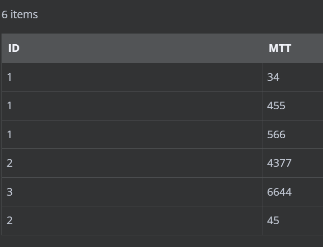

My problem concerns the import of numerical values in decimal format that isn’t working. N8N is not retrieving values of type 2.4 as 24; instead, the decimal point disappears. How can I resolve this issue?
This my data csv files :
ID;MTT
1;3,4
1;45,5
1;56,6
2;43,77
3;66,44
2;4,5

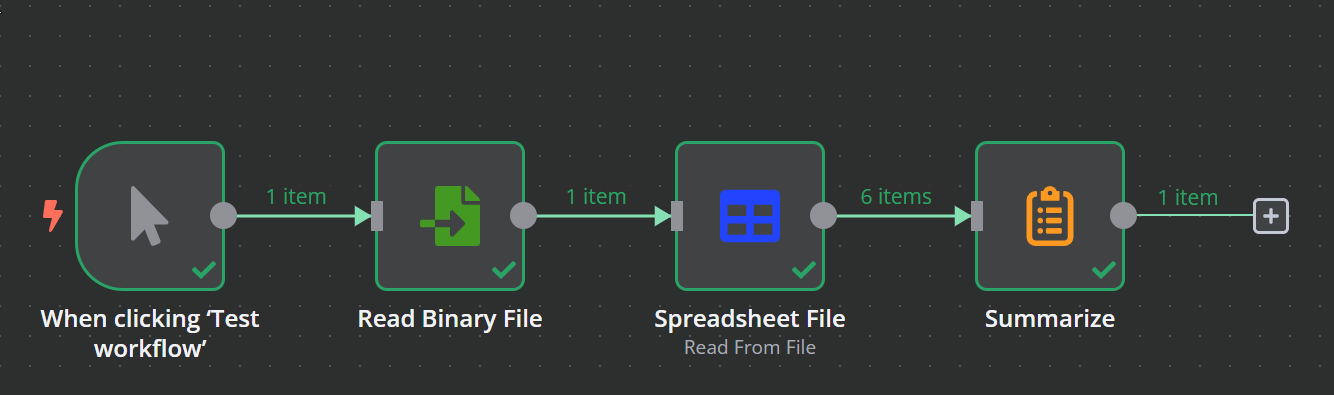

and this is my workflow
This is the n8N traitement node and all float number are gone :
how fix this please ?
hello @Issa2024
I don’t see any isssues with it
But you should use Extract from File instead of Spreadsheet File node ( where did you get it? )

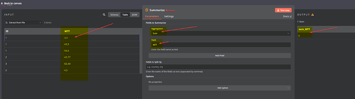

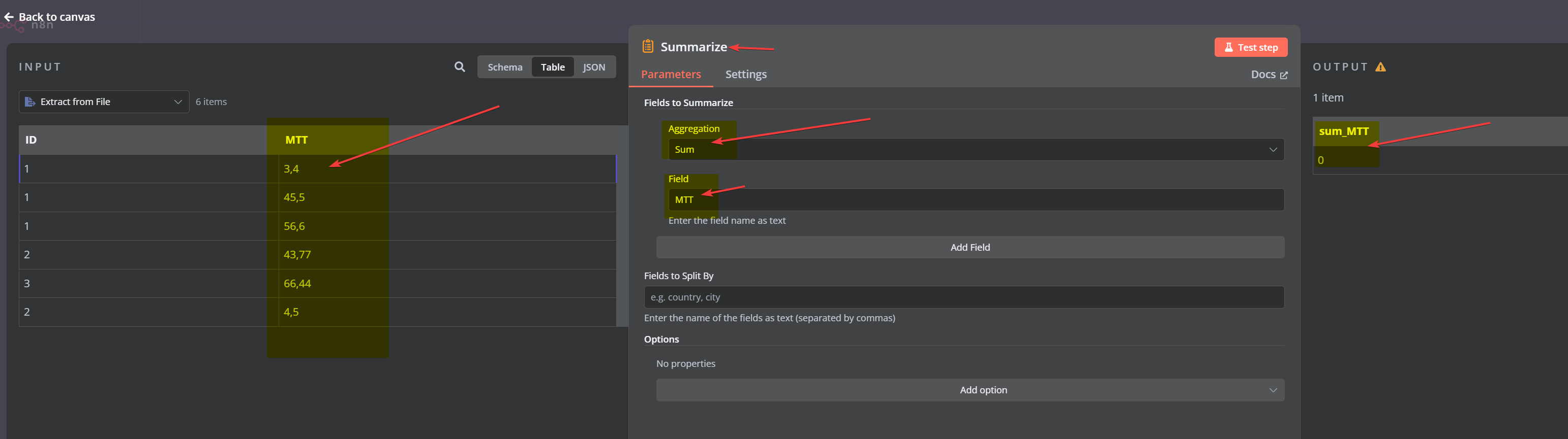

Hello the sum not working :slight_smile:
why the number is not detectable like a float ?
can we user summarize node or i have to make it with code node ?
Thanks
Open the Schema tab and check the type of MTT variable. it’s most likely a string.
You can fix the value with an Edit Fields node
