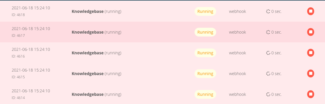

All of a sudden my workflows are just ‘running’. They’re all based on web hooks, when I send the workflow to the test url it and watch it - it works fine. When I send it to the live URL, the expected actions of the workflow are running but it’s constantly stuck in this ‘running’ state and that ID number of the execution keeps going up and up until I pm2 kill n8n.
I’ve upgraded N8N, recreated the workflow, but it’s happening with every workflow now. Any ideas?
Update:
I’m unable to stop those executions - it just comes up with an error. If any of them do retire, the status changes to ‘unknown’ and I’m unable to open the execution.

Panic over! I haven’t broken N8N! :relieved:
One of the webhooks from another app was returning an error but with a 200 code, presumably confusing n8n. Strange that it kept trying new executions though, it once went up to 20,000 executions, but they’ve thankfully gone after restarting n8n

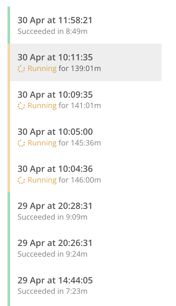

Is there any way to stop the ones that are already constantly running?
I put the if statement in the flow at the beginning to stop future ones, but I still have a bunch that say they are running.
Ive tried hitting the “stop execution” button but it gives an error saying it cannot find the ID.
I have also tried ‘docker compose down’ and ‘docker compose up -d’ again to see if that would kill it, but it did not.
Any other thoughts?
They are not actually running, n8n just thinks they are running, probably because n8n never saved a “successful” or “failed” status for them.
afaik the only way to remove them is to delete those executions from the database.
