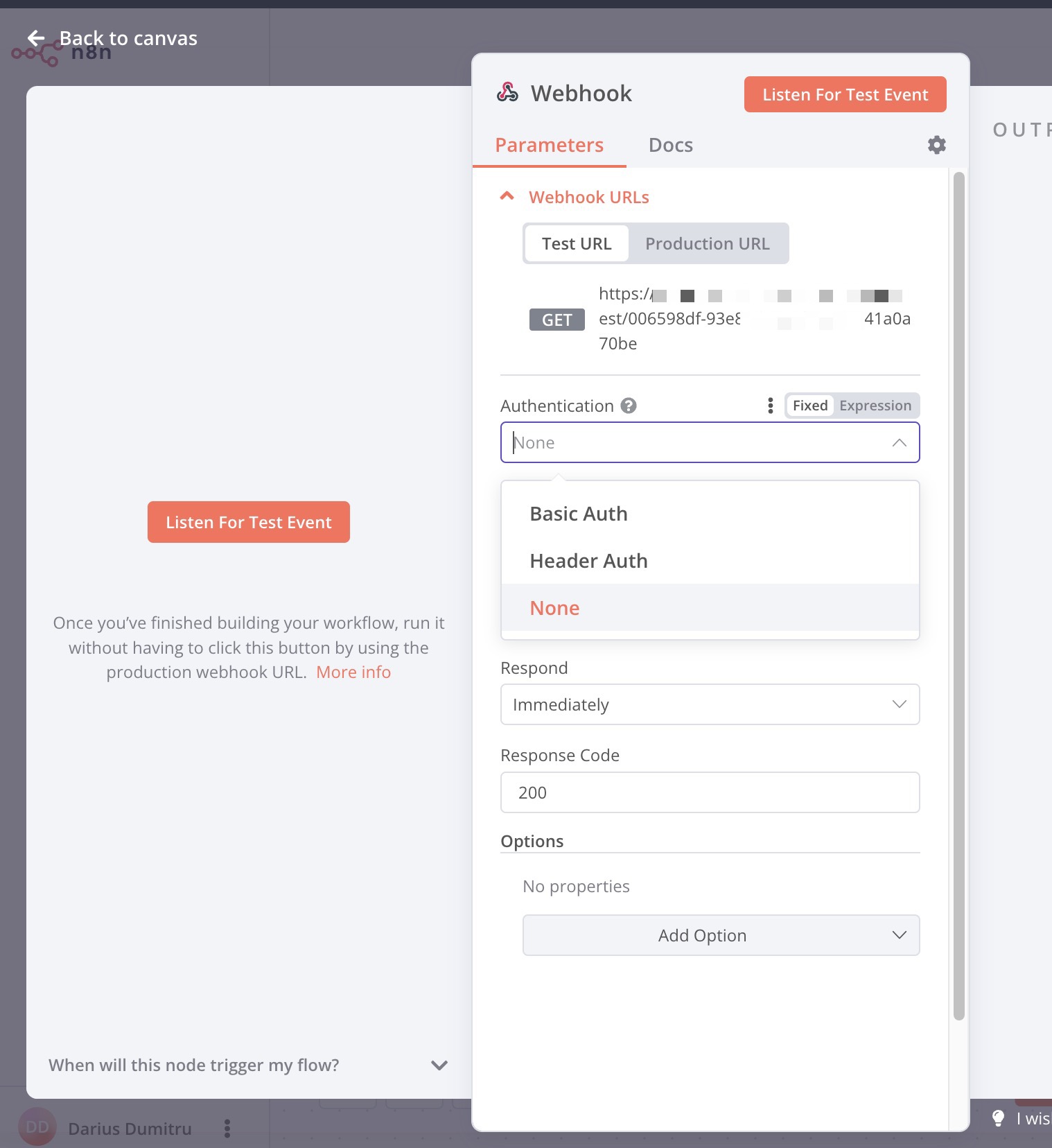

I’m using a Webhook node and Flowlu API documentation (Flowlu API), because there’s no native Flowlu node, and my problem is that I can’t seem to be able to authenticate.
In their documentation they offer API Key or OAuth 2.0.
When using the HTTP node and OAuth2.0, everything works perfect. But, with Webhook node, I don’t have the OAuth2.0 auth method.
From Flowlu docs, I can see that I can use the “api_key” name and “API ACTUAL KEY” value. Tried that with Basic and Header Auth, but no luck.
If I choose “None” / “Basic” / “Header” (any of the 3), and try to test the Event, it’s always waiting for the event to trigger.
Is there any way I can auth the Webhook node with Flowlu?
Waiting for an event. No error.

Hi @Darius_Dumitru :wave:
First things first - the webhook node is for getting data to n8n, so I’m not so sure auth is going to be needed here, as it’d be data that Flowlu sends to us.
I think the problem is that you’re using GET instead of POST as mentioned in the docs here for their webhooks: Flowlu API
Can you try switching over to POST, then click on “Listen for test event” in the Webhook node, and then finally trigger an event in Flowlu sent to the test URL of the node? That should fix this up for you :+1:

@EmeraldHerald oh yeah, silly me, it was driving me crazy, maybe the only option I haven’t tried. Thanks a lot, it’s working fine now.
