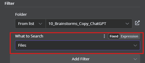

this error usually means you are trying to download something you don’t have access to, or something that is not a file (e.g. folder).
Add additional filter
You are a legend.
Thank you, this solved my issue.

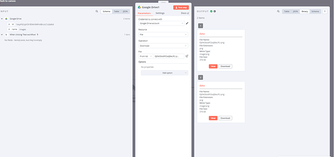

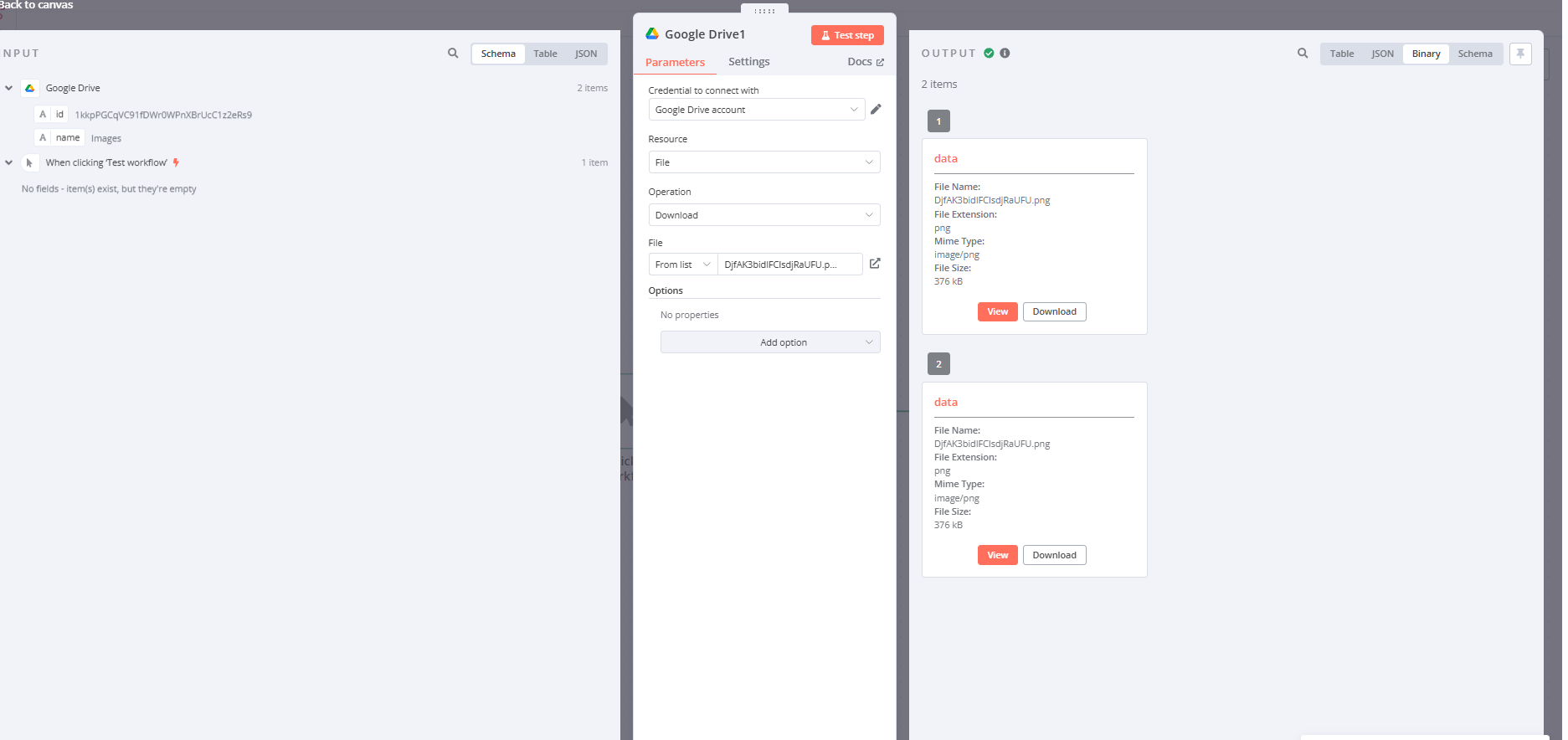

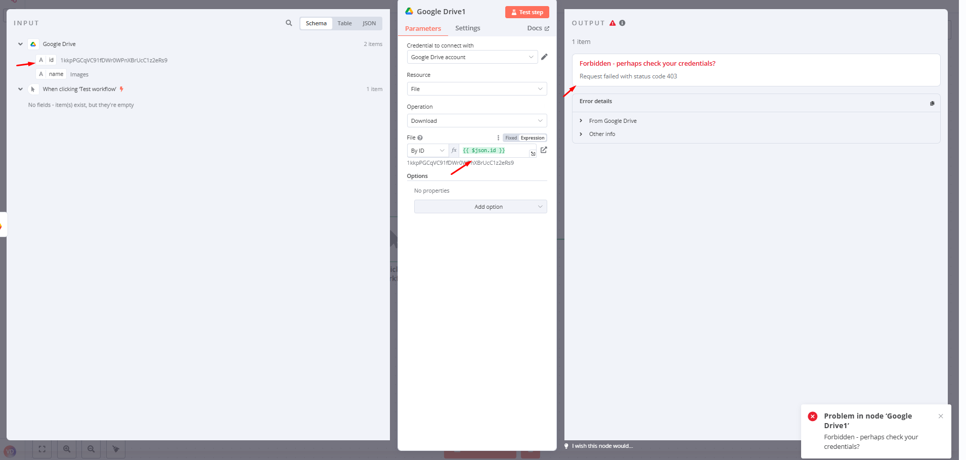

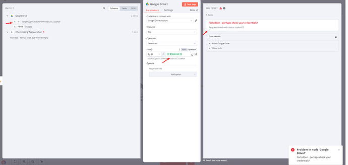

Hello.
I’m encountering the same problem, when trying to insert the file id, though it works if I manually select a file…
hello @Victor_Donea
I suppose the “Images” is a folder and not a file. That’s why you can’t download it. ID that you’ve pasted is not the same as the ID with from the issue.
