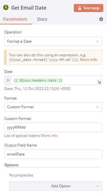

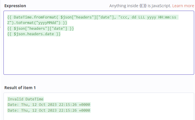

the gmail seems to send
Thu, 12 Oct 2023 22:15:26 +0000
but there’s another node
Not sure where this format is from.
But anyway I came up with
{{ DateTime.fromFormat( $json[“headers”][“date”], “ccc, dd LLL yyyy HH:mm:ss Z”).toFormat(“yyyyMMdd”) }}
but it’s invalid.
My final goal is that I get gmail sent from different web forms. I create contacts and the notes field should have
“yyyyMMdd” + [form name]

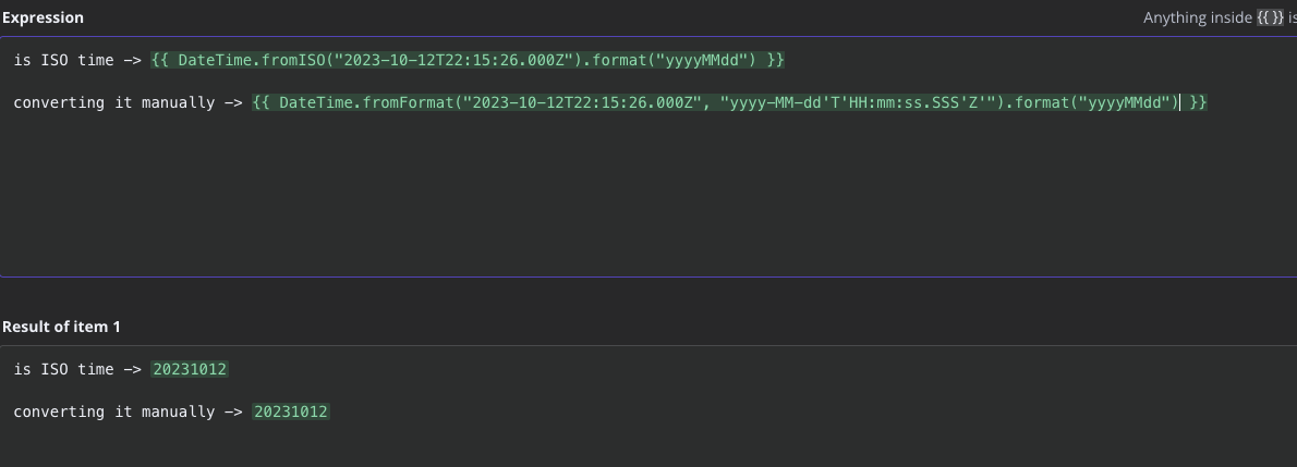

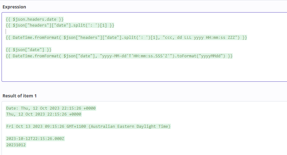

That time shown is actually in ISO format so it’s easy, just use .fromIso("").
If you waned to do it manually. that would be yyyy-MM-dd'T'HH:mm:ss.SSS'Z'
See the picture below
Thanks. Finally got it green
{{ $json.headers.date }}
{{ $json["headers"]["date"].split(': ')[1] }}
{{ DateTime.fromFormat( $json["headers"]["date"].split(': ')[1], "ccc, dd LLL yyyy HH:mm:ss ZZZ") }}
{{ $json["date"] }}
{{ DateTime.fromFormat( $json["date"], "yyyy-MM-dd'T'HH:mm:ss.SSS'Z'").toFormat("yyyyMMdd") }}

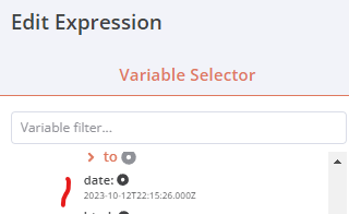

Do you know where
{{ $json[“date”] }}
came from? It’s not
And from what I understand the expression always has to be a single line and I cannot use things to make it easier to read such as intermediate variables.
Is there any way to make this more manageable because I can’t imagine having this in multiple nodes and trying to keep them updated?
Hey @bally,
$json tends to mean the data is coming from the input so this means the node before has a date field in the output which is where it is coming from as to why it is different I am not sure it could be that one is a sent date and one is the local recieved date.

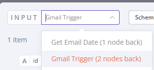

what are thoughts on using a node like this
of course this means everything will have to specify specific nodes
which also seems a bit messy - especially if I ever want to rename the trigger
