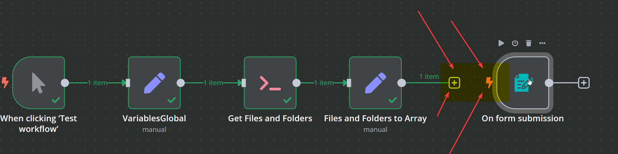

Hello,
i can’t add date before the node trigger ?
do u know how to do it adding information for a select form before the form start ?

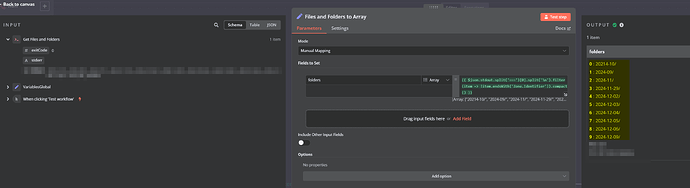

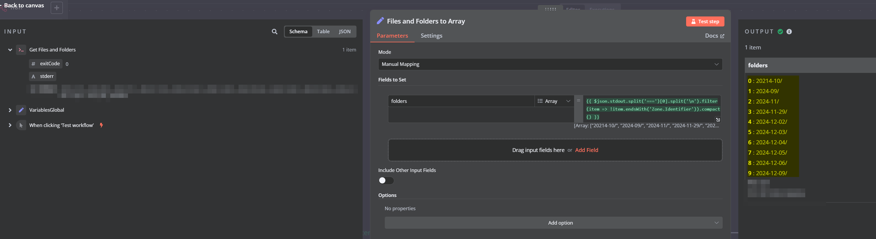

Exemple :
I create a script to get value and i want adding this data on the form on select form :

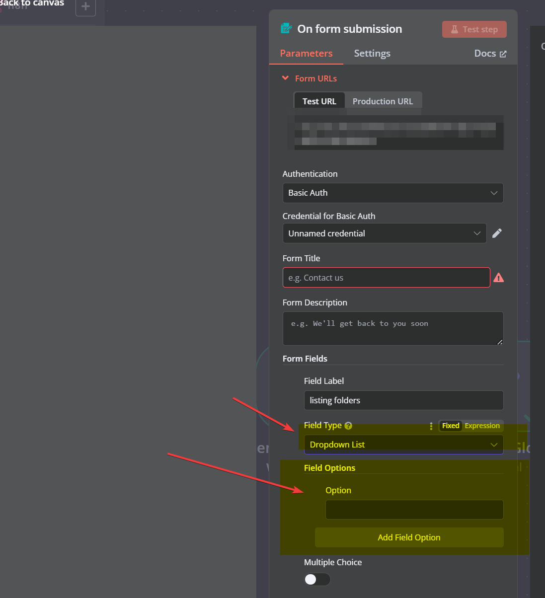

this is the data for the form to populate :
and i want adding this here : and populate the form
can i do that please ?
hello, you will need a Next Form Page node for that

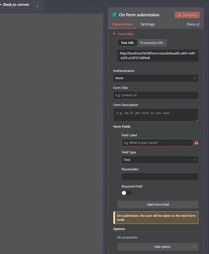

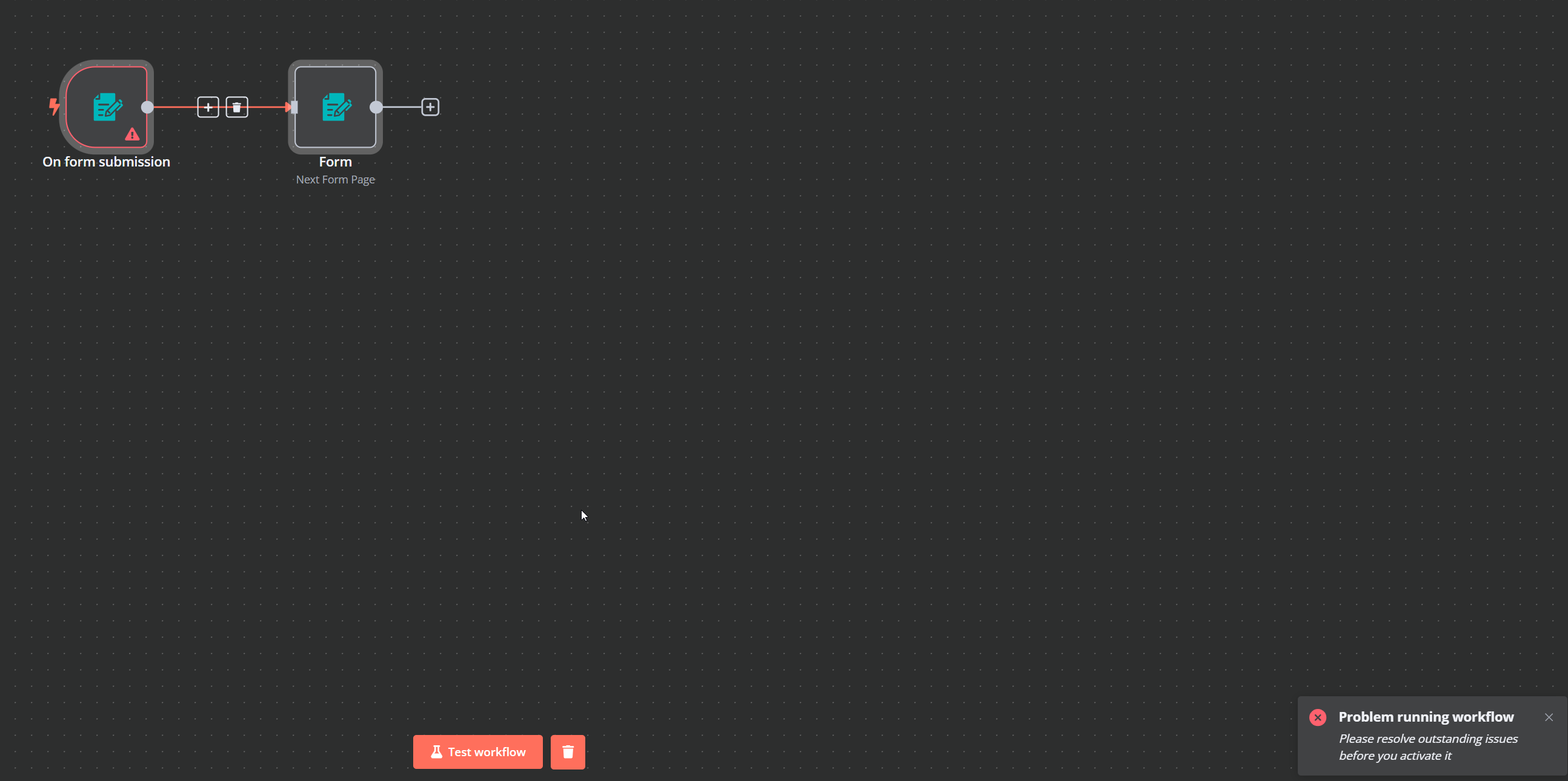

Hello thanks but this form are error and i can’t lunch it :confused:
because field are empty :
i think i missing somethings :confused:
Because that’s an example… you should adapt it to your use case
