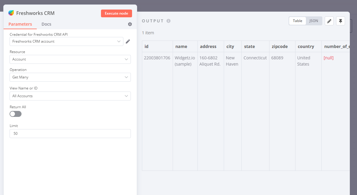

Sorry for the trouble. I just gave the below workflow a go on my side:
I didn’t run into trouble here with a new Freshdesk account on n8n cloud:
Is there a chance you have copied the full URL rather than just the name of your subdomain in your credentials? So instead of https://supportteam-518064794859834034.myfreshworks.com/
, you’d have to use supportteam-518064794859834034
in this example:
