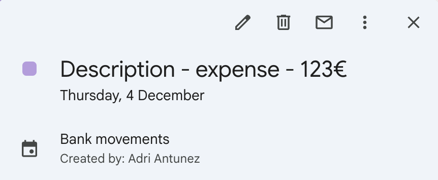

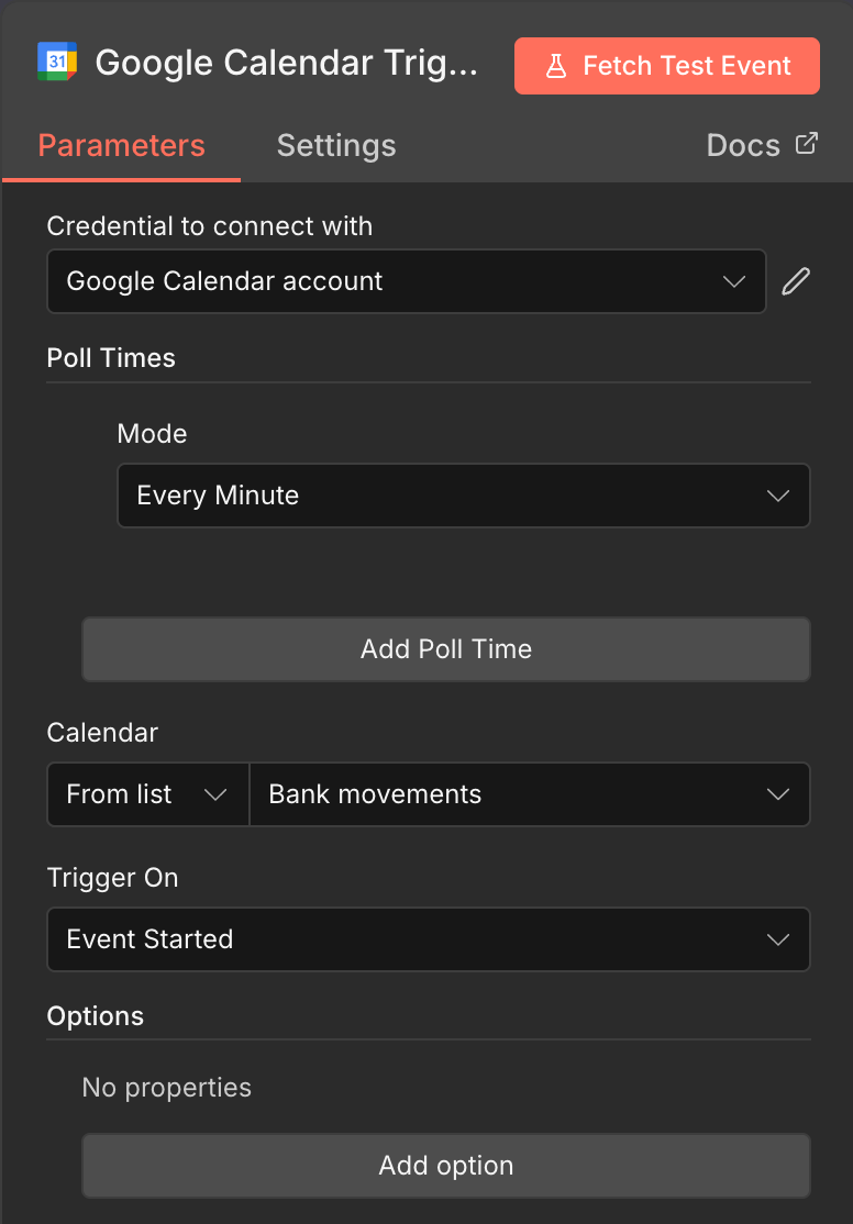

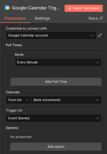

N8n workflow is not triggered when all-day events start, but workflow is triggered on timed events.
I’ve triple-checked that the event calendar was created before starting the day, server/docker date is correct, workflow is enabled, credentials are in place, etc.
No error message, simply workflow doesn’t trigger
Configuration Screenshots
This one doesn’t trigger the workflow

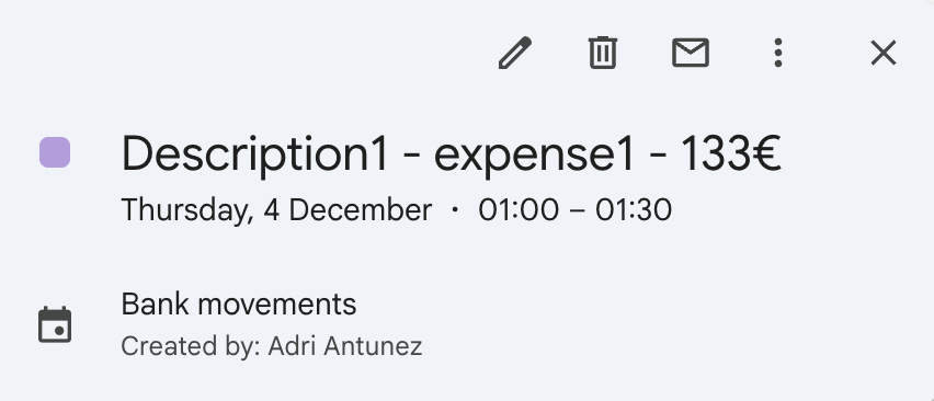

This one triggers the workflow:
  • n8n version: 1.122.3 (self-hosted)
I would appreciate any hint on how to solve this. Thanks a bunch!

Still no luck on the all-day events. Might it be a bug? For now the only workaround I’ve found is to turn all-day events into timed-events (e.g: 00:00 to 00:15).
Yeah, i tested it, it doesn’t go through, n yeah i think it needs to have a specific time for the webhook to be fired, i am not sure if it is a bug from the n8n itself or from gCal itself does not send it
