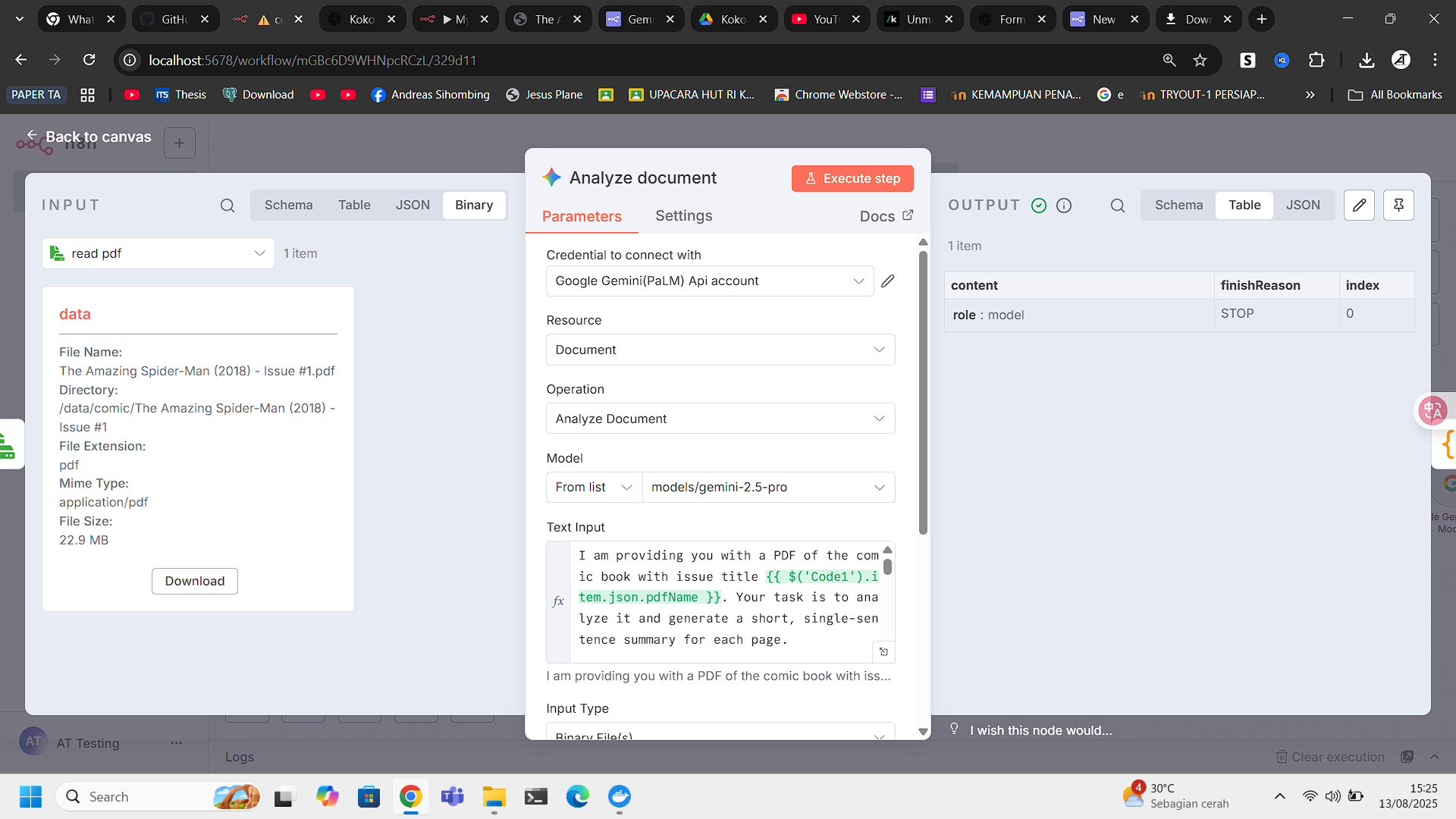

Difficult to judge without seeing the workflow but the error shown in the screenshot maybe because you are setting “Require specific output format”. I would suggest testing with that turned off to make sure that the model is generating some output from your transcript and then take it from there.
I have tried specific output formats for a few workflows. If the objective is a specific JSON output format then and I have needed to specify the output format in the prompt - with an example - as well as attaching a structured output parser.
i don’t think it because “Require specific output format”. Here it screenshot without “Require specific output format” the output its empty, it’s happen occationaly without any warning, i think maybe this is another gemini bug for 2.5 pro,
The fact that you get a “STOP” in your finish response tells me the workflow stopped because of an error. What the error is not immediately evident.
My first hunch went to the Require Specific Output, but looks like you eliminated that.

Sorry to hear about your experience. I’m not sure this is fixed. I’ve had the same troubles with my current workflow/s: they regularly – and seemingly randomly – return empty or zero-result outputs without throwing explicit errors. I have two Gemini 2.5 Pro nodes across two connected workflows, and they ‘fail silently’ as often as they succeed. During one run, one will fail, and not the other. Or vice versa. Or both will pass. Sometimes both fail. I’m curious as to whether you rebuilt the workflow in question to resolve the issue – or did it just ‘come right’ of its own accord? I’ve been through so many attempted fixes – from relaxing safety settings, to reducing input token count, but nothing appears to work. Google Cloud Console throws up no useful reporting on this… Thanks in advance.
Well. my need use of gemini pro for creative use. Right now i’m using 2.5 Flash. i saw on community you can use a unique prefix, but for me it’s still 30 70 chance (70% fail). If i really need 2.5 pro i usally build loop workflow if error gonna execute again, until in success. but right now 2.5 flash still good for me personally

The solution for me was:
Ensure you are on the correct “billable” google cloud project. else this won’t work
Ensure you have given permissions to “Vertex User” and/or “Vertex Admin” to your project - Gemini apparently uses this and if this fails, its just doesn’t respond. That’s what happened to me.
Ensure API permissions are available on the cloud project you are using Gemini on.
Looks like problem is still an intermittent problem for you. At some context length or attachments etc to the chat, vertex kicks in. Simple chats may work. Perhaps that explains the transient nature of this.
Let me know if any of the above helps. I can try to share the exact steps if needed. If it’s’ working, good luck.
