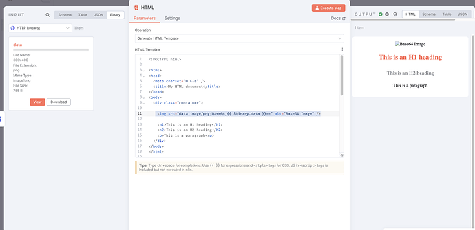

An n8n binary response from a node cannot be converted into base64 inside n8n?
I think you need a script to convert the response to base64

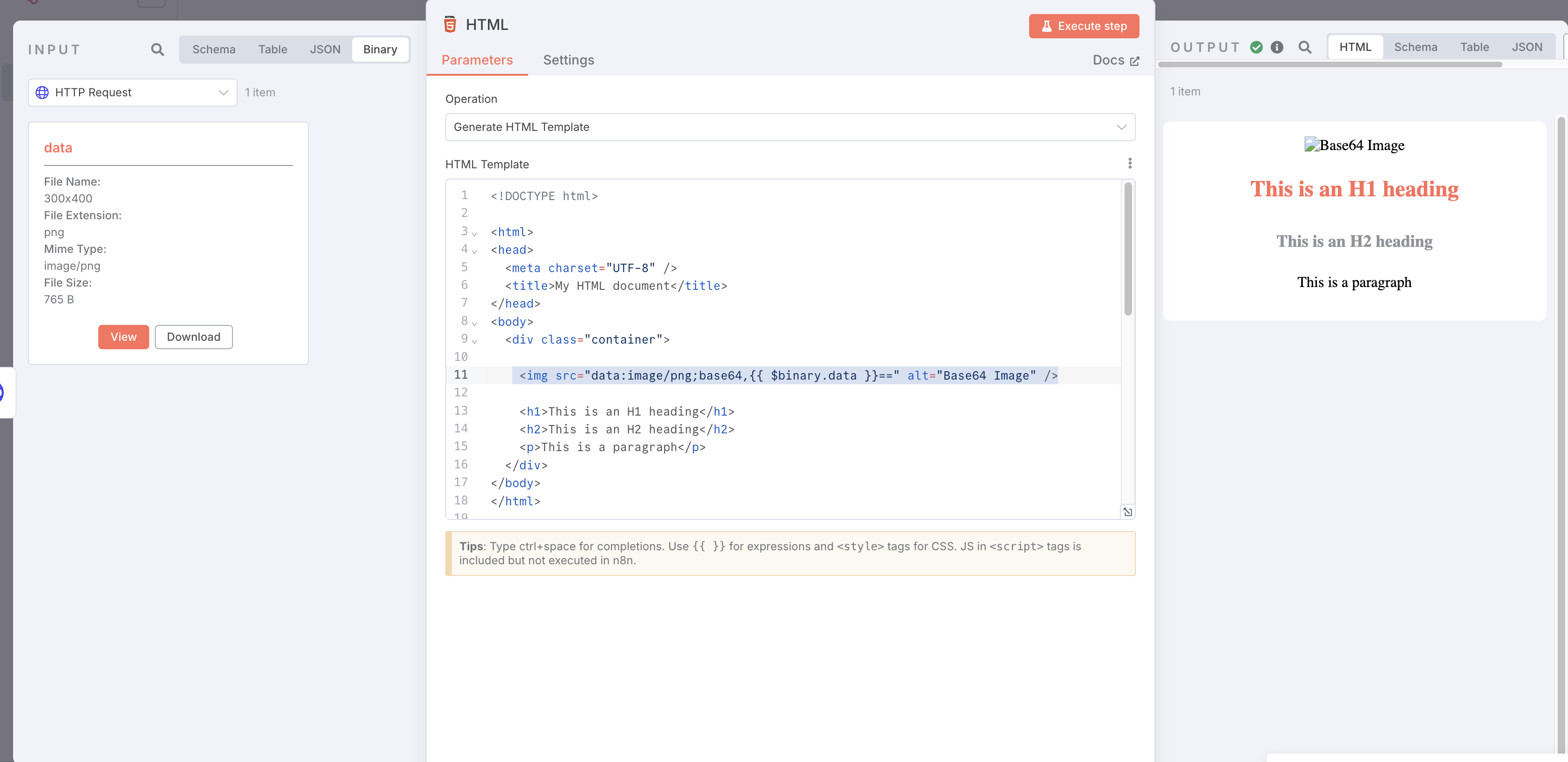

Yes, you can use the base64 node
Use this node to convert the binary data to base64 and then use the string in the html node

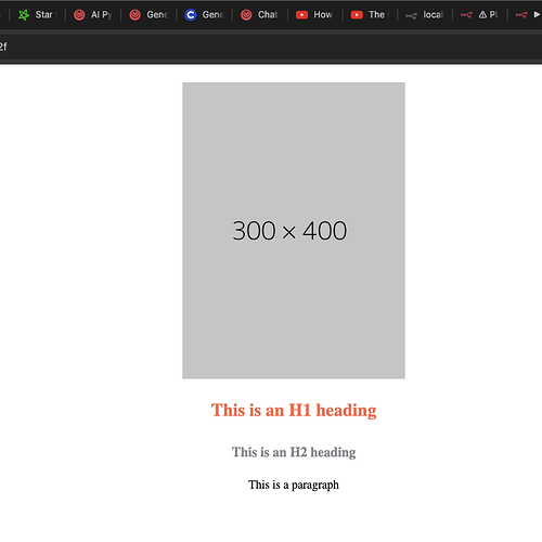

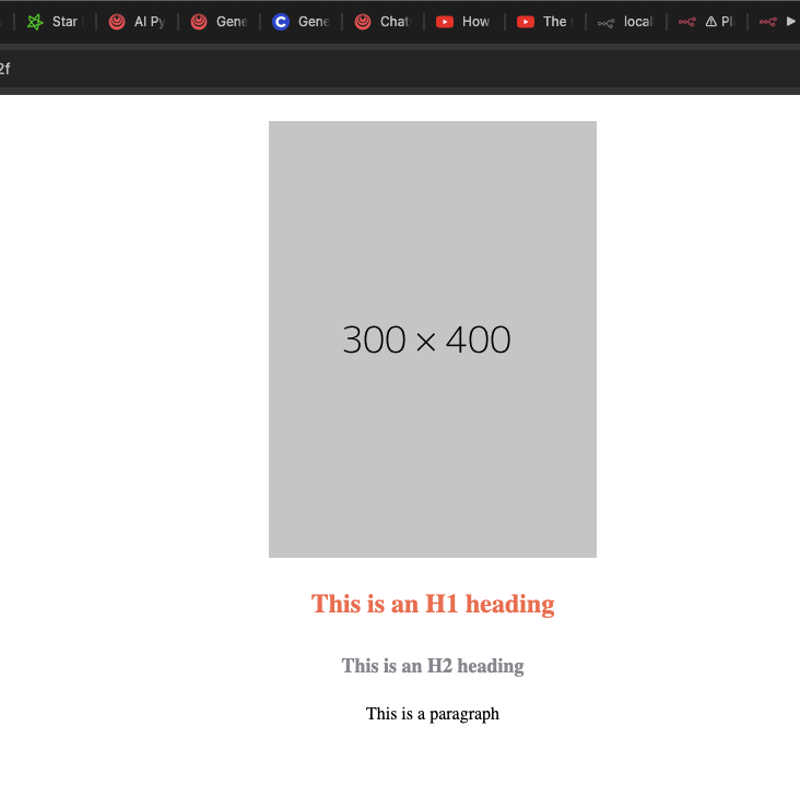

Full example below. PS the editor preview might not render the image hence I added the webhook and respond nodes to test in browser. Also I removed the hardcoded == from the html node since base64 will auto add that
Thank you. This is exactly what i was looking for, I had difficulty figuring out how to extract a requests binary data and chatgpt was giving me incorrect solutions.
