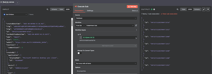

The ID which is used to get children in a OneDrive-Node is the first one, in that case “94F1CF51181F044F!6714”
It’s also correclty taken over to the execute Sub-Node as you can see in the screenshot, where you can also see, that it is correclty fetching the different IDs for the different Folders. Then it’s only spitting out the Input, cause I detached the Sub-WF-Start from the performing part, because it’s failling due to a missing ID for the “Get Children”-Part in that.
The Main WF is also correclty updating the Workflow Inputs as I change them in the Sub-WF and refresh them in the Main-WF. So the connection between the two seems to be working.
Main-WF- Execute Sub - Node

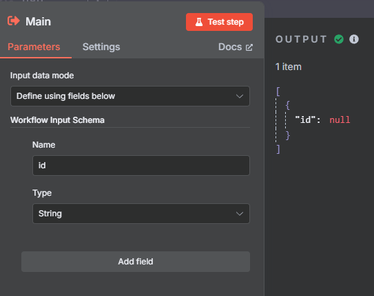

Sub-WF - Start-Node
Is that everything you need?
How did you get the output of the sub-workflow? Did you press the View sub-execution link or manually clicked on the “Test Step” button of the trigger?
I clicked it manually… I didn’t get that there is a difference… Thank you!!!
I feel stupid now :nerd_face:
But THANKS!!!
I will post my last result, when I’m done :slight_smile:
yes, Test Step will only evaluates the variables to null. It doesn’t run the parent workflow.
