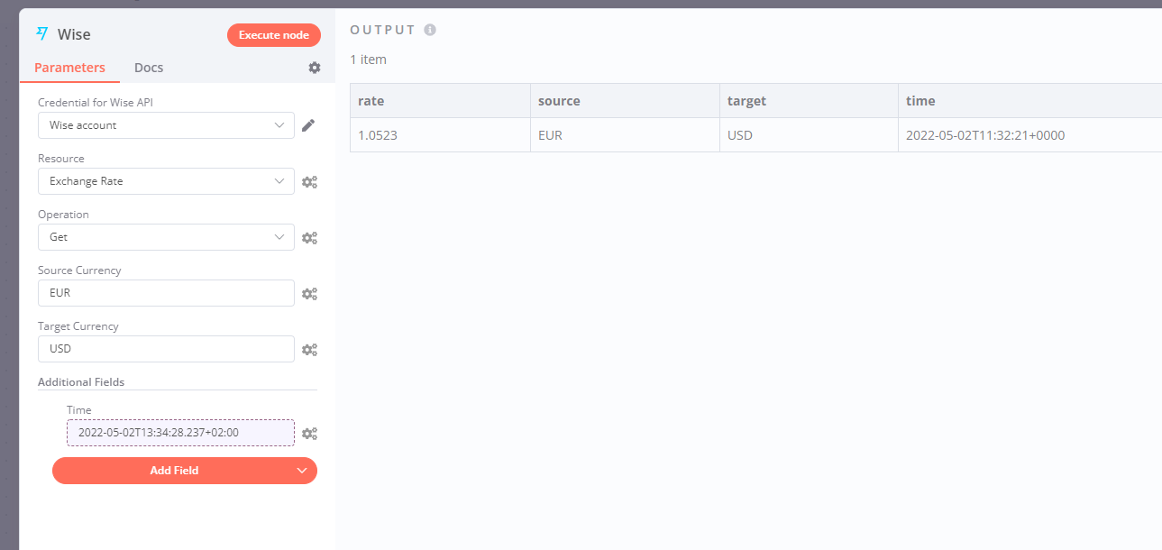

@ovizii with the fix now released you should be able to use a workflow like below once you have upgraded to [email protected]:
This will return only the current exchange rate:
No need for the workarounds mentioned further up :slight_smile:
