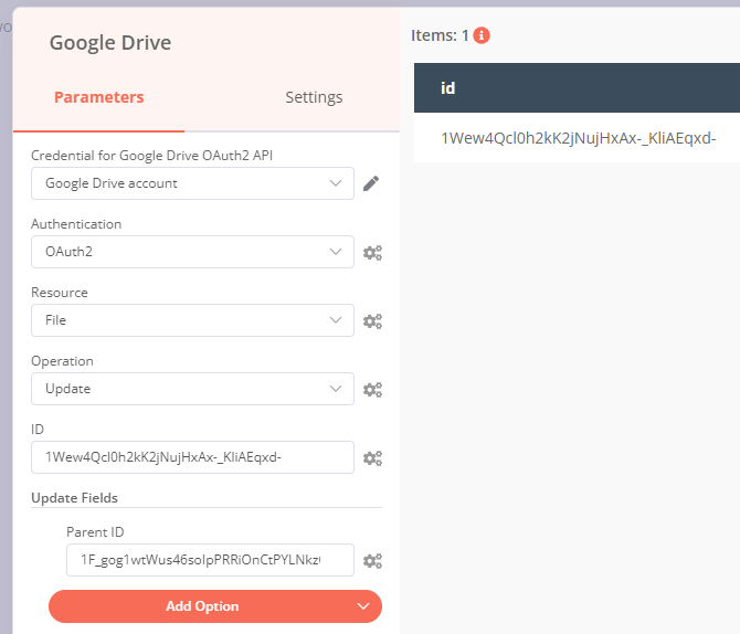

Hi @Gregory_CHAURAND, I quickly tried this but could move a file just fine using the File:Update operation of the Google Sheet node:
So in order to reproduce this, could you confirm how the other user created the file you were unable to update and how it was shared with you?

Thanks for confirming @Gregory_CHAURAND! Was actually testing this with an OAuth account using which it wasn’t a problem for user B to create a file in a folder shared by user A and afterwards move it out of said folder by updating the file.
Would using OAuth perhaps be an option for you?
