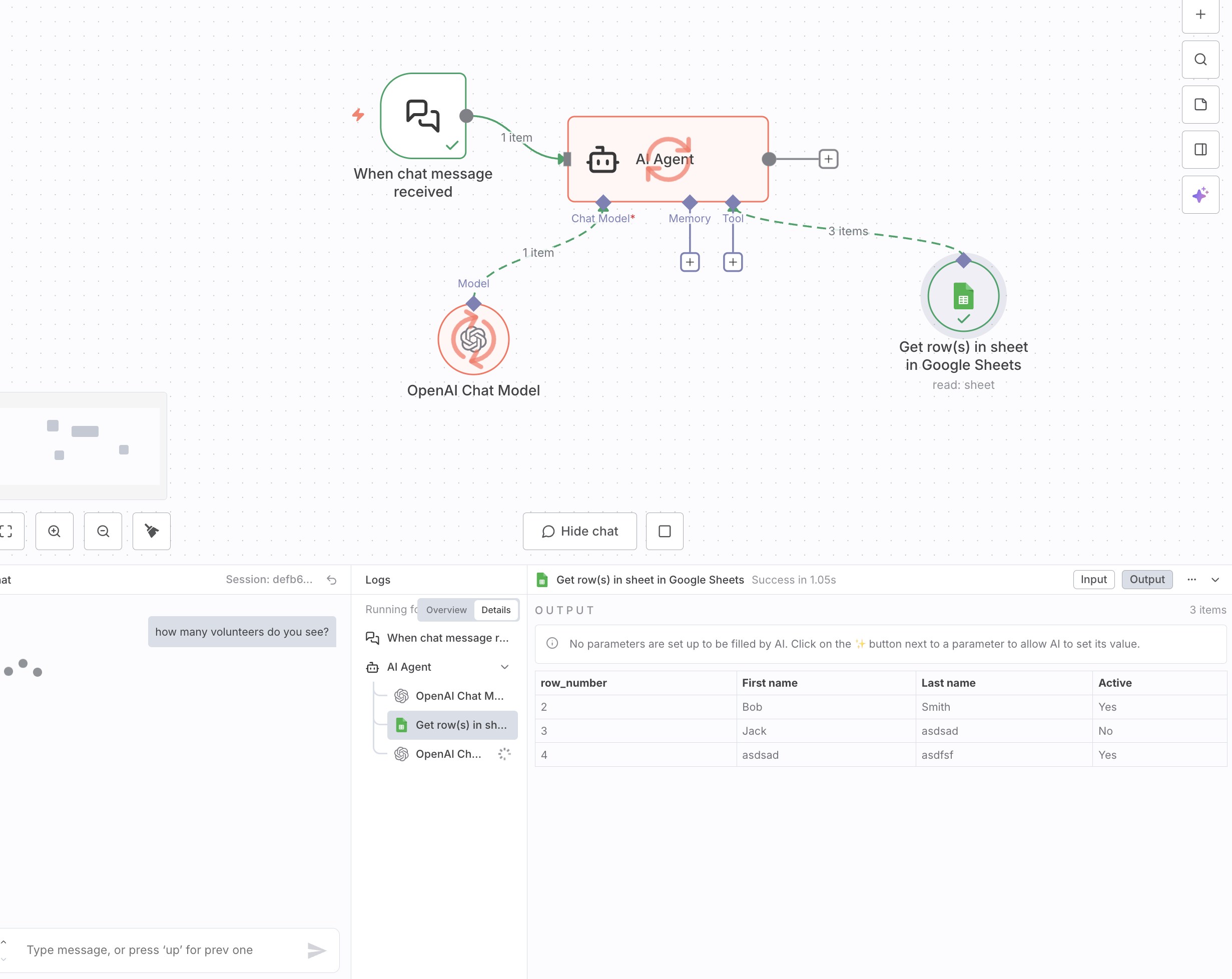

I am trying to read the number of rows from this sheet in “Google Drive”. The tools call does get “3 rows” from google sheet, but I have absolutely no clue why the LLM call only passes in the 1st row, which only gives me the value of 1.
The LLM request to OpenAI should have the 3 rows in the “REQUEST”.
Any help is much appreciated. Thanks.
System: You are a helpful assistant.\nHuman: REQUEST: how many volunteers do you see?\nAI: Calling Get row(s) in sheet in Google Sheets with input: {"id":"call_...."}\nTool: {"row_number":2,"First name":"Bob","Last name":"Smith","Active":"Yes"}

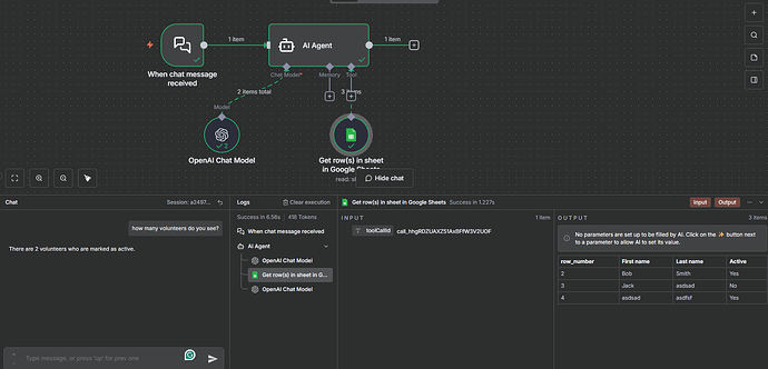

I tested your setup and confirmed it works correctly. You should consider changing the OpenAI model; I used gpt-4.1-mini.

Hi CY1234, I made the same workflow and by giving relevant system prompt to agent, It start working as per expectation, I recored the video as well, You can clearly see the implementation.

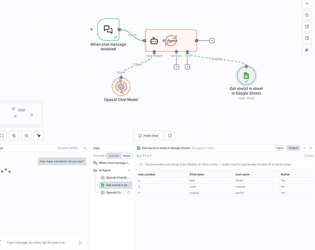

I actually think this might be a bug, depending on the version of n8n you’re running, which might explain why some users can run this and some can’t.
In my case, I did have this working back in the end of Oct, but had upgraded my n8n version.
Nothing has worked.
did you tried updating your n8n version? they fixed the bug in new release
