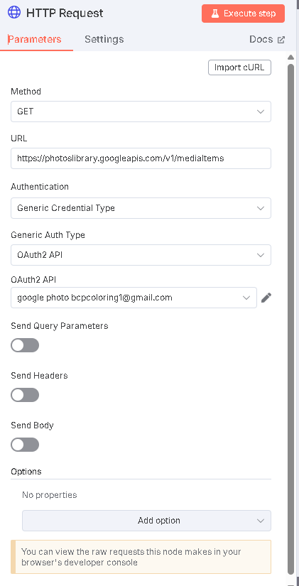

but it just didn’t work for me. Here’s my setup:

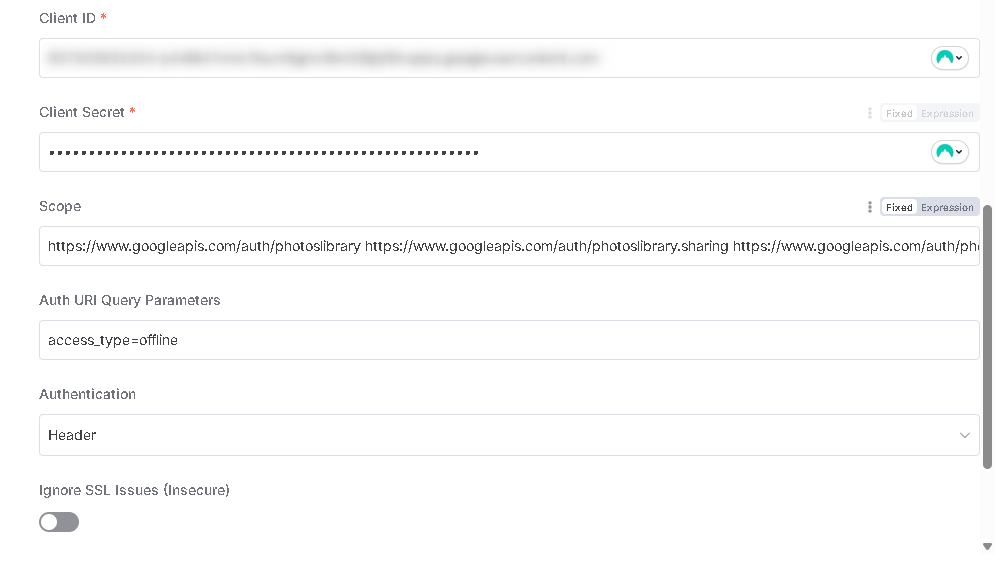

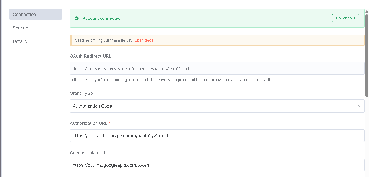

and my credential setup in the node generic credential type > Oauth2 API:
The scope in the above are: https://www.googleapis.com/auth/photoslibrary https://www.googleapis.com/auth/photoslibrary.sharing https://www.googleapis.com/auth/photoslibrary.edit.appcreateddata

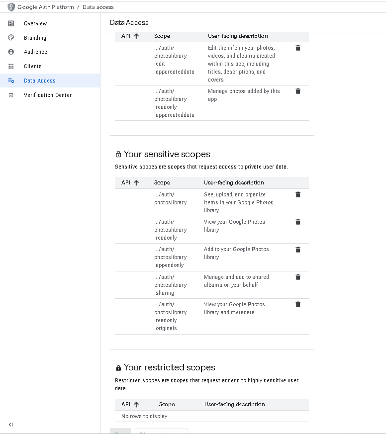

Finally, in my google console, I have the following scopes enabled:
