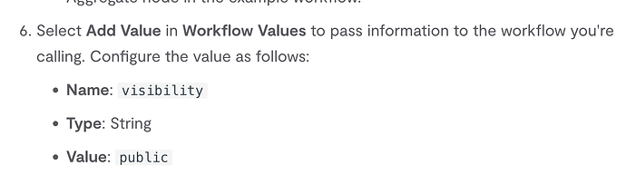

Hi @Jon - thanks for getting back to me on this.
Yes I tried the tutorial but it uses a hard-coded parameter which is sent to the workflow:
What I am trying to do is use parameters that are generated by AI and send those to the workflow.

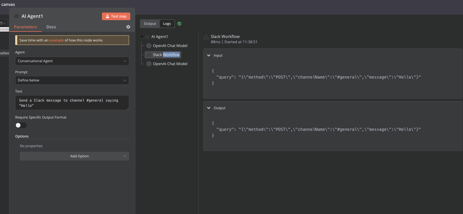

@James_Pardoe As others pointed out, the structure output parser should only be used for the final output. But I would advise you to use a simple chain just for parsing the output since adding the formatting instructions can sometimes confuse the LLM.
Regarding the tools calling — agent can only provide a single dynamic argument to the tool, so you need to ask it to pass a stringified object if you want it to provide more. Here’s an example:
This would correctly pass the arguments to the tool as stringified JSON:
Regarding the ERROR: Single ‘}’ in the template. error you’ve mentioned, that seems to be due to some clashes in the Langchain expression language; I’ll have a closer look at what’s causing it. But in the meantime, you can get around this by escaping the curly brackets using double-curlies, which is what I did in the workflow above.
Ah thank you so much! This makes sense and I look forward to running with it!
