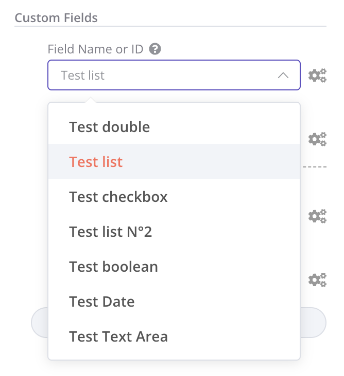

Since there can be multiple lists, an issue arises when the user refreshes a list that isn’t the last one that has been added.
If there are two lists, list1 and list2 :
when the user refreshes list1, they get the list values for list2, which is incorrect.
This makes Test list have the list values options related to list 2
This is because of how getCustomFieldListValues has been implemented.
This is why it would be nice to find another way to get the relevant custom field.
→ Do you think there is a way to get around this issue ?
