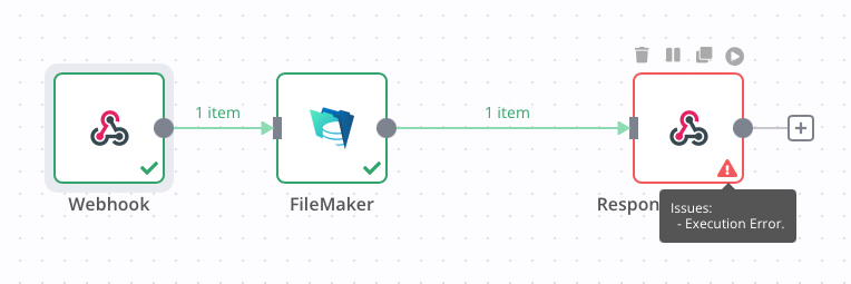

Thanks very much! Your tip to build a node, test it separately to populate it with data and the go to the next node, made me solve one problem. Now I’m left with an issue in the Respond to Webhook Node. I’m using {{$node[“FileMaker”].json[“response”][“data”]}} but apparently this does not work, whereas when I’m building, all lights are green.

Hey, I’ve sent you a dm with the booking link. As for the error you are seeing, this usually happens when trying to parse JSON data that doesn’t need parsing.
This seems like a bug to me (and I’ll take a closer look later), but should be easy to avoid. Instead of your expression {{$node["FileMaker"].json["response"]["data"]}}, could you try using {{JSON.stringify($node["FileMaker"].json["response"]["data"])}}? This uses a bit of JavaScript to convert your data into a string (which can then be parsed without the error).
Hi, great! That works. Just had to change the Webhook Respond from ‘When last node finishes’ to Using ‘Respond to Webhook’ node.
