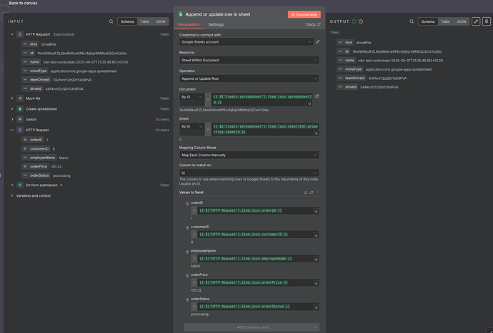

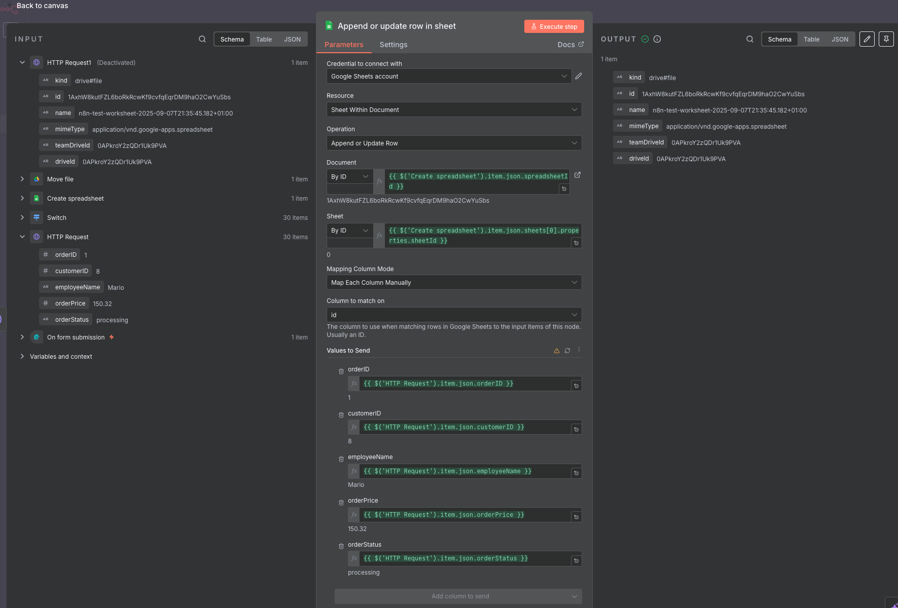

Hi @jabbson thanks for taking the time, regardless of what i try, if i deactivate the “HTTP Request1” immediately preceeding and activate the upstream “HTTP Request” node.
This happens …
This indicates you are working not with the latest version of the sheet.
Please click on the circle with arrows to update the fields.

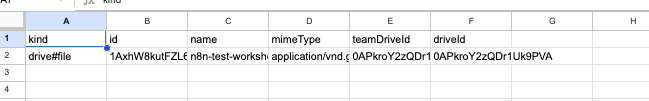

Yes and when i do, it picks up the fields from the immediately preceeding node - Google Drive Move File.
I dont want that, I want it to pick up the fields from upstarem HTTP Request node.

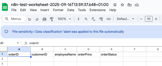

This is what i want:
This what im getting:

Yes but kind, id, name, mineType etc are outputs of the preceeding Move file node. I don’t want those.
I need the columns orderID, customerID, employeeName, orderPrice, orderStatus outputs of the upstream HTTP Request node.
But as you can see the “Append or update row in sheet” node will not see or accept those outputs from the HTTP Request node.
If however I move the “HTTP Request” Node downstream to immediately preceed the’ “Append or update row in sheet” node, then it will pick up the correct outputs.
How can i maintain the HTTP REquest further upstream where I need it, yet still have the “Append or update row in sheet” node pick up its values.
As stated previously I have alredy tried moving t back upstream and editing all expressions to include node reference specifically. Stil doesnt work though
{{ $('Http Request').item.json.orderID }}
My final output, regardless of the HTTP Request node location, should be like this in googlsheets:
Not

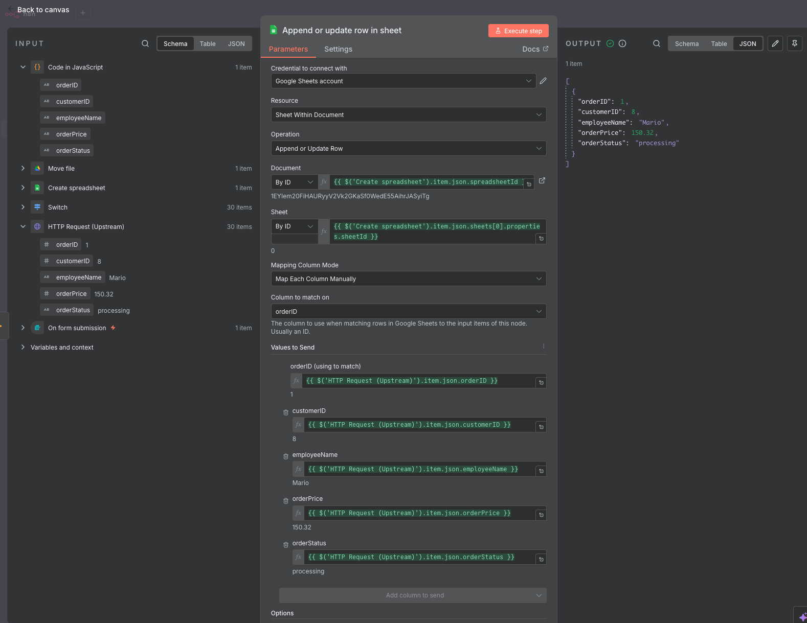

On the http request —> googlesheet apend issue
After watching something only slightly related on youtube, I decided to add a code node before the googlesheet append node to set column headers.
This results in me being able to consitently map to the fields from upstream http request node as follows:
Now my googlesheet append node looks like this:
Note on a first run through of the workflow the output is empty, right hand side. Also reflected ina googelsheet with column headings but no data:
If I then execute the node again in isolation I get a single row output:

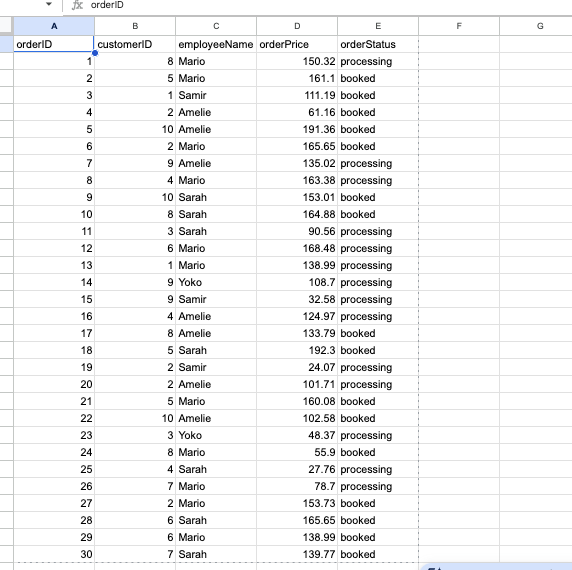

Also reflected in the googelsheet with column headings and one row of data now:
