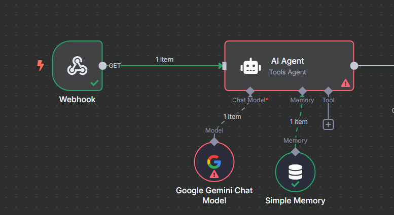

Getting error while using webhook and simple memory
[GoogleGenerativeAI Error]: Error fetching from https://generativelanguage.googleapis.com/v1beta/models/gemini-1.5-flash:streamGenerateContent?alt=sse: [400 Bad Request] * GenerateContentRequest.contents[0].parts: contents.parts must not be empty.
whenver im using simple memory im getting error.

Hi, @Sathish
Are you sure you’re passing something to the AI agent? I mean, how are you handling the data coming from the Webhook?
