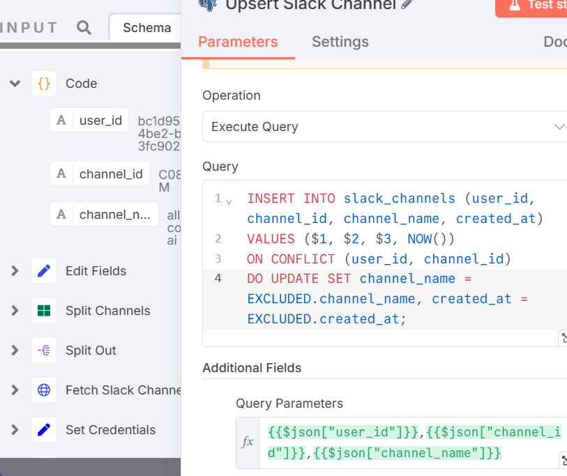

Getting errors in postgress sql
INSERT INTO slack_channels (user_id, channel_id, channel_name, created_at)
VALUES ('{{$json["user_id"]}}', '{{$json["channel_id"]}}', '{{$json["channel_name"]}}', NOW())
ON CONFLICT (user_id, channel_id)
DO UPDATE SET channel_name = EXCLUDED.channel_name, created_at = EXCLUDED.created_at;
error – invalid input syntax for type uuid: “{{$json[“user_id”]}}”
n8n version: 1.91.3 (Cloud)
Problem: I’m passing the values dynamically to the postgress node even i can see the values but when I test the flow I got the above mentioned error. I tried to hardcode the values in quotes then it is working fine. Please help me fix this issue

I tried without quotes as well but no success. I think variables defined in the query parameters are not connected with the query itself. Because i can see the values inside the query parameters and when i test the node it returns uuid null. Not sure what’s going on. I’ve setup a set node before the postgress node and I’ve the set the variables as well

I’ve a separate node just before the postgress, where i have set the variables like this
“user_id”: “{{ $node[‘Set Credentials’].json[‘user_id’] }}”,
“channel_id”: “{{ $json[‘id’] }}”,
“channel_name”: “{{ $json[‘name’] }}”
now I can see those values by clicking on query parameter and then results but still the issue persists. If you need some additional info please let me know i can provide that. Thanks

look what i am doing wrong here i am getting the values from previous node, and it’s been visible in query parameters results as well but still user_id is being passed null
