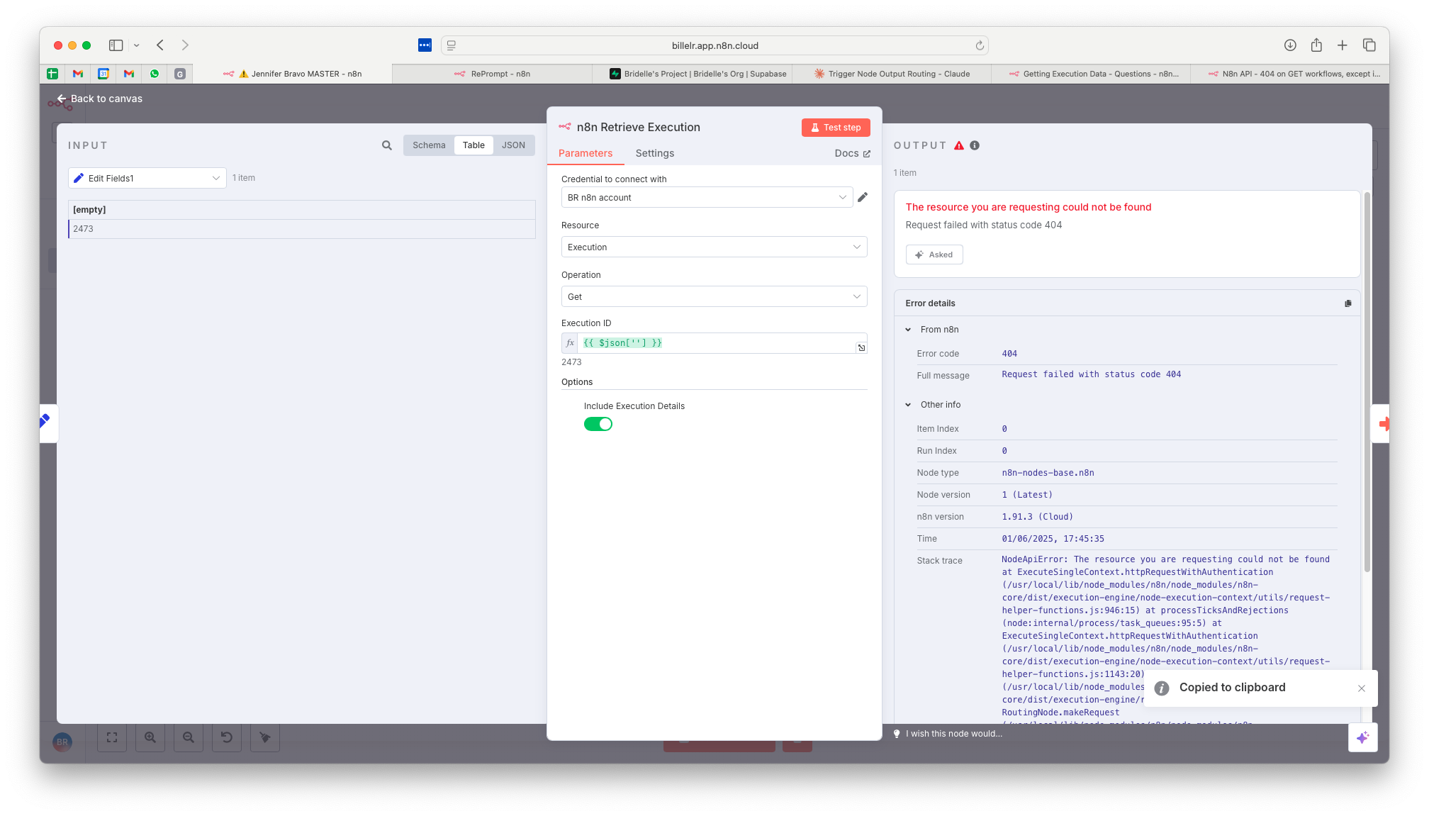

I am truing to setup a last step in my workflow that would download the execution data and pass it to another workflow, I’ve setup my n8n API key correctly and im using a set node just before the n8n to extract the execution ID.
The problem im facing is that no matter what I do the n8n get execution never works.
I tried inputting the {{$execution.id}} formula right in the n8n node at first without the set node before and it didn’t work either.
See nodes below:
Anyone faced the same issue ?
Any help would be appreciated, im on the cloud version.
Error message: {
“errorMessage”: “The resource you are requesting could not be found”,
“errorDescription”: “Request failed with status code 404”,
“errorDetails”: {
“rawErrorMessage”: [
“httpCode”: “404”
“n8nDetails”: {
“nodeName”: “n8n Retrieve Execution”,
“nodeType”: “n8n-nodes-base.n8n”,
“nodeVersion”: 1,
“resource”: “execution”,
“operation”: “get”,
“itemIndex”: 0,
“runIndex”: 0,
“time”: “01/06/2025, 17:45:35”,
“n8nVersion”: “1.91.3 (Cloud)”,
“binaryDataMode”: “filesystem”,
“stackTrace”: [
“NodeApiError: The resource you are requesting could not be found”,
" at ExecuteSingleContext.httpRequestWithAuthentication (/usr/local/lib/node_modules/n8n/node_modules/n8n-core/dist/execution-engine/node-execution-context/utils/request-helper-functions.js:946:15)“,
" at processTicksAndRejections (node:internal/process/task_queues:95:5)”,
" at ExecuteSingleContext.httpRequestWithAuthentication (/usr/local/lib/node_modules/n8n/node_modules/n8n-core/dist/execution-engine/node-execution-context/utils/request-helper-functions.js:1143:20)“,
" at RoutingNode.rawRoutingRequest (/usr/local/lib/node_modules/n8n/node_modules/n8n-core/dist/execution-engine/routing-node.js:319:29)”,
" at RoutingNode.makeRequest (/usr/local/lib/node_modules/n8n/node_modules/n8n-core/dist/execution-engine/routing-node.js:406:28)“,
" at async Promise.allSettled (index 0)”,
" at RoutingNode.runNode (/usr/local/lib/node_modules/n8n/node_modules/n8n-core/dist/execution-engine/routing-node.js:139:35)“,
" at WorkflowExecute.runNode (/usr/local/lib/node_modules/n8n/node_modules/n8n-core/dist/execution-engine/workflow-execute.js:739:26)”,
" at /usr/local/lib/node_modules/n8n/node_modules/n8n-core/dist/execution-engine/workflow-execute.js:921:51",
" at /usr/local/lib/node_modules/n8n/node_modules/n8n-core/dist/execution-engine/workflow-execute.js:1257:20"
