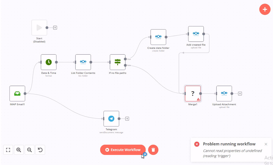

thank you very much. I have copied the code and change things like folder path, IMAP Account etc.
The Merge1 is an error. Any Idea why?
It tells me the node is unkown:
That is the version I am running:
Any Idea what I did wrong?
Hey @Monasucks_EVE,
That looks like you might need to update n8n to use the new merge node… Although if you are using Desktop this won’t be possible at the moment and you would need to add in the merge node again.
so far so bad. As I am using the desktop version. Whats the solution to fix this as it is not working with that merge node…
How to fix this?
Problem executing workflow
There was a problem executing the workflow:
“Date & Time: The date input format could not be recognized. Please set the “From Format” field”
That Date & Time gets this error… thats why I had to disable that all. How to fix that thingy?
