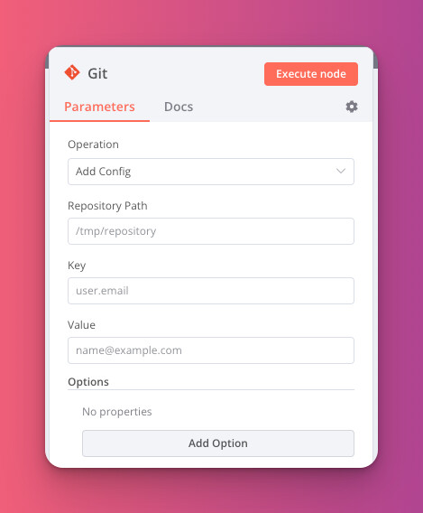

"parameters": {
"operation": "addConfig",
"repositoryPath": "={{ $('Set variables').item.json.codefolder }}",
"key": "user.email",
"value": "={{ $('Set variables').item.json.git_email }}",
"options": {
"mode": "set"
"id": "myid"
"name": "User e-mail",
"type": "n8n-nodes-base.git",
"typeVersion": 1,
"position": [
3160,
580
"alwaysOutputData": true

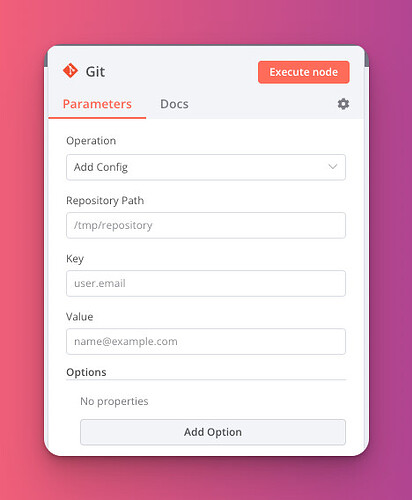

"parameters": {
"key": "=user.name",
"value": "={{ $('Set variables').item.json.git_username }}",
"options": {}
"id": "myid"
"name": "Git username",
"typeVersion": 1,
"position": [
3360,
580
