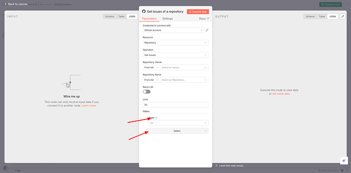

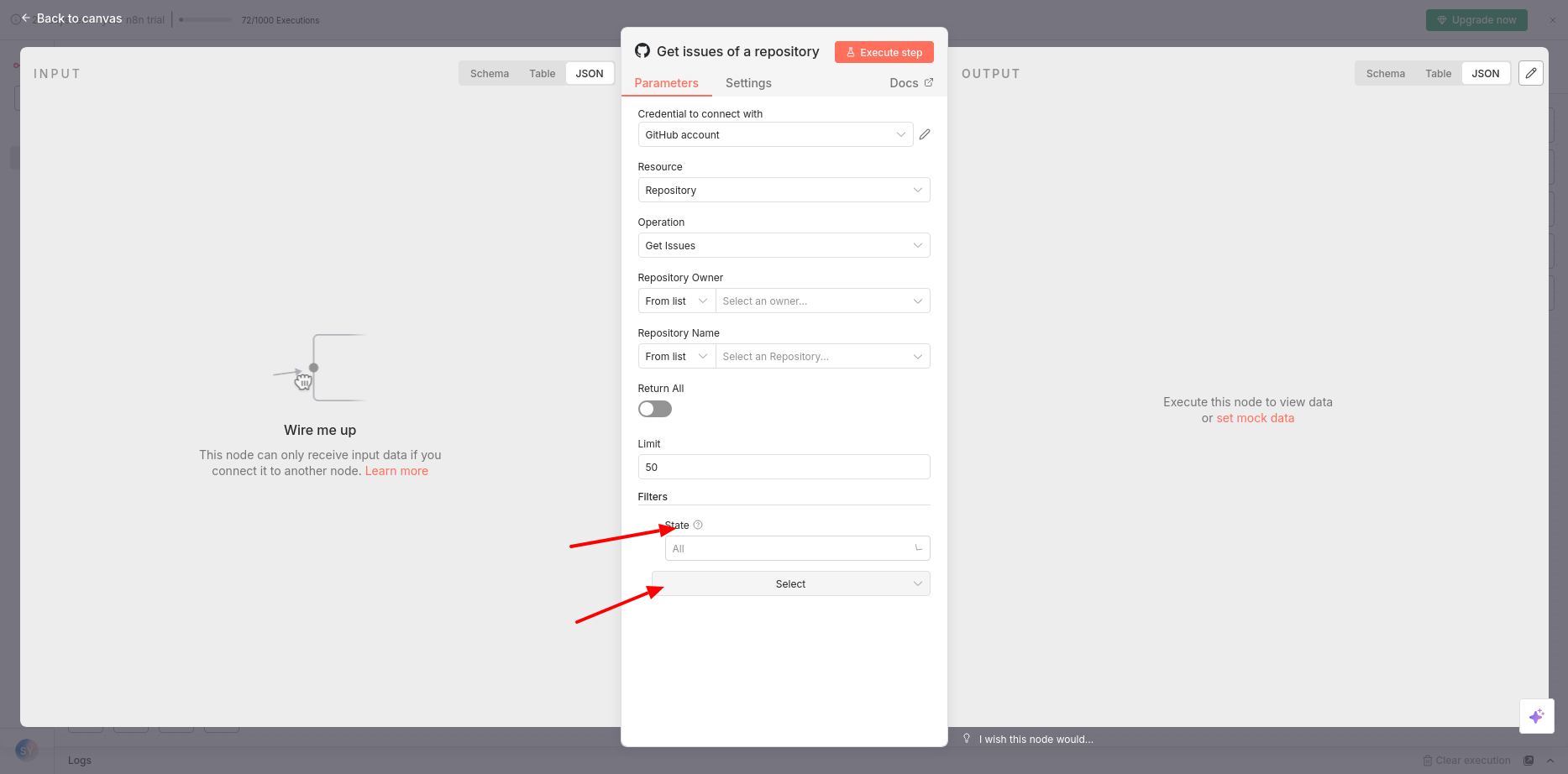

@andig
for getting all issues. you must add a filter
add filter and then select state and then choose all
Ouch, indeed. Thank you, much appreciated!
You’re welcome and mark the answer as a solution please.
