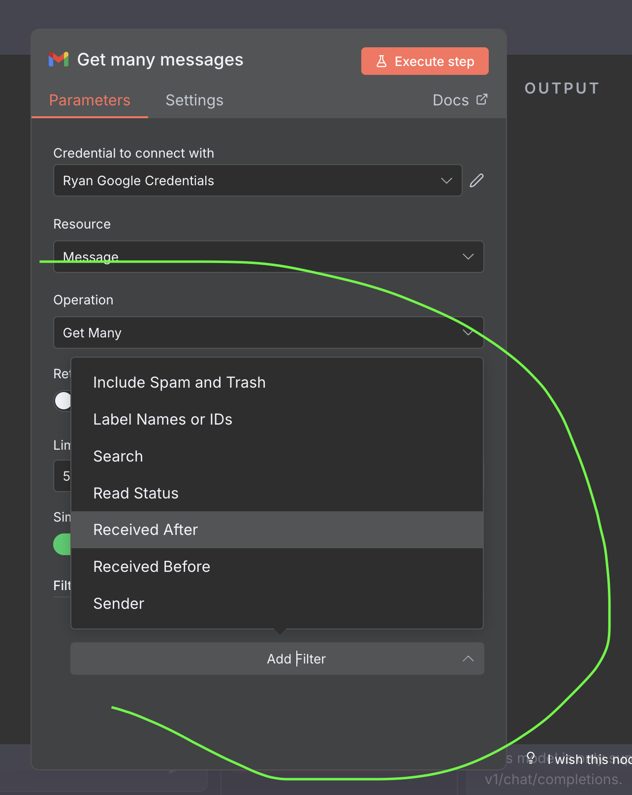

My Gmail inbox is too large and running Get many → Return all takes too long and fails. I changed it to Get many and set a limit of 5 as a test. I was hoping to set a schedule as a trigger until I grabbed everything, but every time it runs during testing, it grabs the most recent. If I don’t receive any new emails in between testing, it grabs the same 5 and outputs them over and over… to a Google Sheet. Is it possible to start with the oldest available mail and have Get many ignore previously retrieved messages?

on the gmail node, theres this option at the bottom to add some type of filter
you can maybe play around with that, maybe have a schedule trigger that will output the current time of tht schedule trigger and only take the last 2 hours of when is tht trigger gets triggered
or only takes the one with a certain label or read status
a lot of options that you can choose, i suggest you to play around with it!

I can’t get any more granular; I’ll have to figure out a different way to do this. Maybe use before and after filter in 6 month increments.
Thanks
yea, tht should definitely work to achieve wht ur trying to do
but because 6 months is such a long time and i assume you will get a lot of email, dont forget to use some loop over items node and wait node on each services so you dont get any rate limit error
