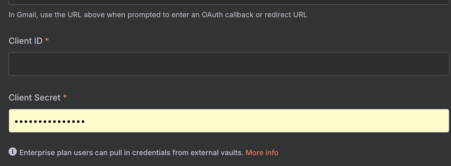

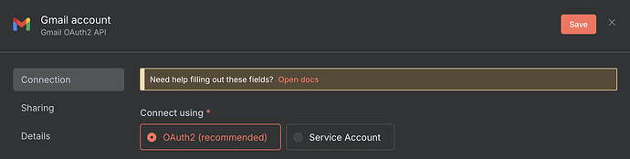

Hi, what version of n8n are you using? Your Gmail node seems incorrect. Images below for reference.
To authenticate with Gmail, you can go to Google Cloud and enable the Gmail API: Google Cloud console
You can then create a client with Google Cloud using this URL https://console.cloud.google.com/auth/clients, which gives you the client ID and secret.

I’m on the latest as of today 1.94.1. I only noticed after that sign in form wasn’t correct. In any case I just cleared my workflows and restarted and it now works and I see the correct sign in. Im not sure what the cause of this was though
I see, I think it was a old version of the node considering it having a grant type. Is everything connected now?
It is the correct localhost. I restarted n8n and Docker container and it now works now but only after deleting my workflow
