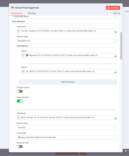

I’m using the Gmail Send & Wait for client review. For response type I’ve selected Custom Form. I have 4 drop downs and 4 text fields. Unfortunately, I can’t attach a pic of the entire node, but I’ve attached a sample.
In my workflow, I have two Send & Wait nodes…one at beginning, one at end. The first works great and collects all data entered into the form. The second node never returns all data. If four text fields have text, it’ll collect text from three and label the other as “null”.

Thanks SO much! You’re very kind to do that. The problem node is Gmail-Final Approval.
My result is even worse…

Thanks SO much for testing! So, is the takeaway a simpler form may be the way to go? I can remove the drop downs from the second Send & Wait node and just keep the textfields and adjust my filter to just look for populated textfields.

Success! I deleted all the dropdowns and just kept the four text fields. I alerted my code node after this one to interpret empty fields as “Approved”. After a couple of tests, it now recognizes all data. Thank you again!
