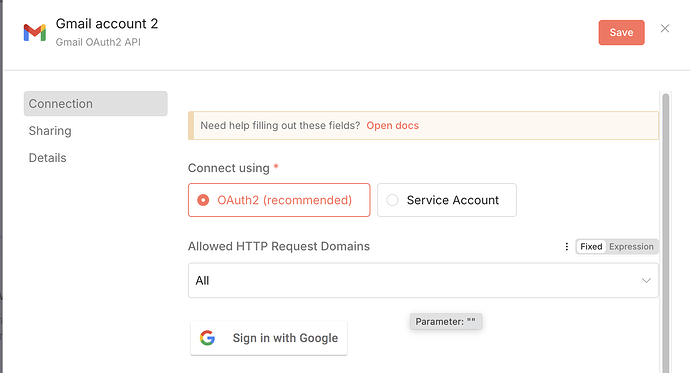

My Gmail Trigger node stopped working. The built-in Google OAuth authorization (using “Sign in with Google” on n8n Cloud) has become invalid. The workflow was working previously but now fails on every poll.
I didn’t change password or revoked app access. After re-authenticating via “Sign in with Google” the trigger works, but I don’t understand why it stopped working or if it will stop again.

What @barn4k referred to is correct. When using gmail oauth, you need to re-auth after some time again as the tokens expires and does not auto refresh. Ideally you need to use a Service Account which never expires, however this will only work on a Google Workspace account which is a paid service for businesses. Public gmail.com accounts are not supported for service accounts.
However if gmail.com is your only option, to get notified when your gmail node fails due to a token expiry, I would advise you to create a workflow and set the Error Trigger. Remember to point your workflow to the error workflow so it can catch errors. Then use something like Telegram to send you errors to your phone.
