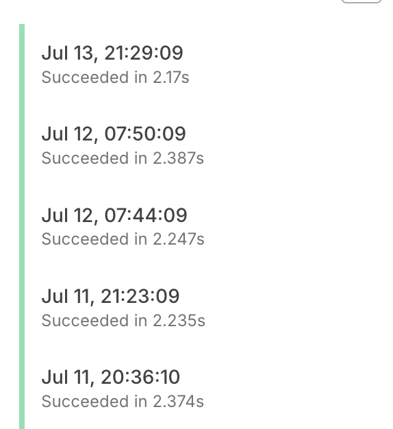

I dont know what you mean exactly, but the workflow seems to have been activated twice yesterday and i havent touched it in a few days. and there where defenitely more mails coming coming into my inbox than the times the workflow has started.

i mean yes it is set to active in execution tab also but like i said the work flow does not activate when a mail comes in unless i start it manually

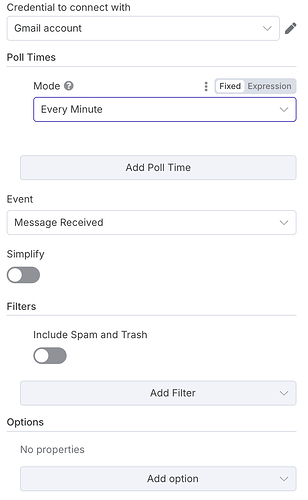

Did i do it right? There wasnt a designated option for one second. just one minute

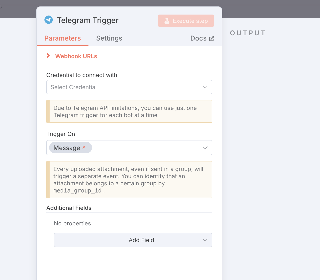

Gmail trigger does seem to be working on the concept of polling, rather than a webhook like Telegram trigger supports. While the doc doesn’t mention it, Telegram trigger has this webhook option while Gmail does not:
I think it’s fair to say that polling-based triggers can take a while to process, and I doubt 1 second can work considering 1 minute is the lowest available polling option.
If you set to 1 minute polling, are you seeing any delays?

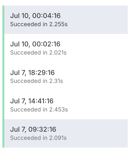

also it worked like a few times over the past days but it seems so random. i got far more emails than it catched
