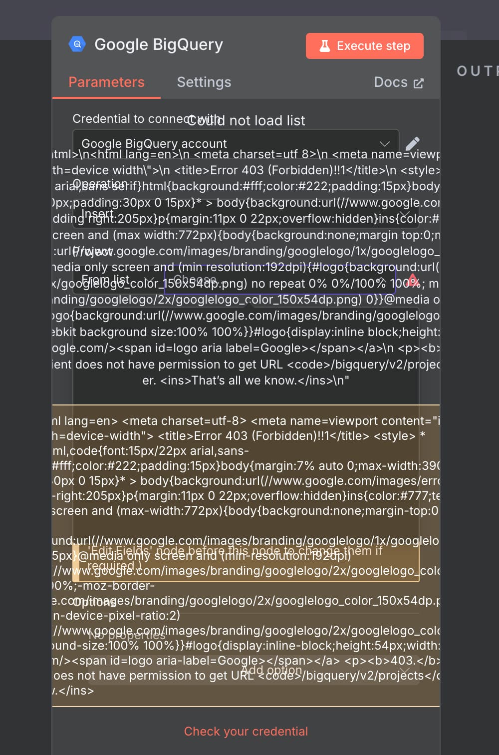

Whenever I use the Google BigQuery node in n8n (v1.98.2, Docker, self-hosted), all API requests to BigQuery return 403 Forbidden – specifically when fetching the project list or executing a query.
The error is always:
403. That’s an error. Your client does not have permission to get URL /bigquery/v2/projects from this server. That’s all we know.

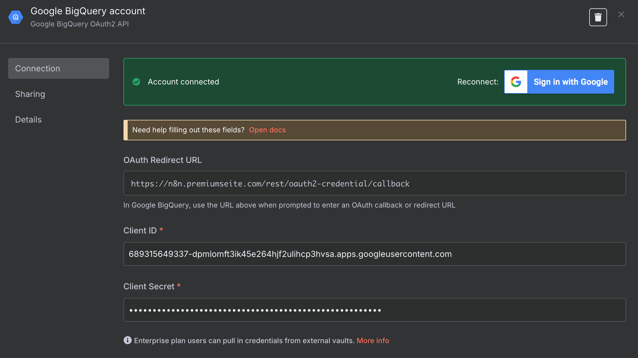

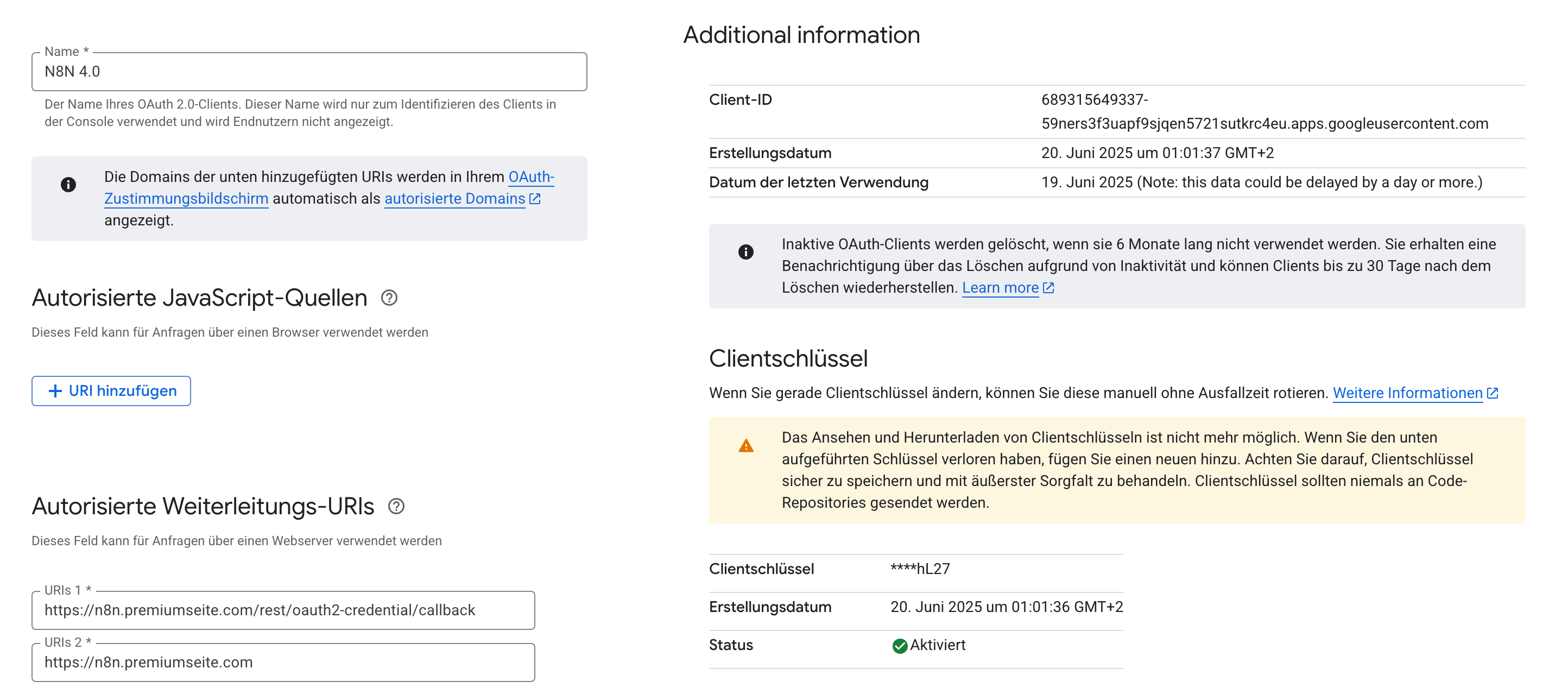

  • OAuth2 credentials

  • Tried multiple credentials (OAuth2, Service Account)

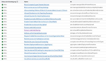

  • Organization policy (constraints/iam.allowedPolicyMemberDomains) allows my domain, I tested with internal and external users

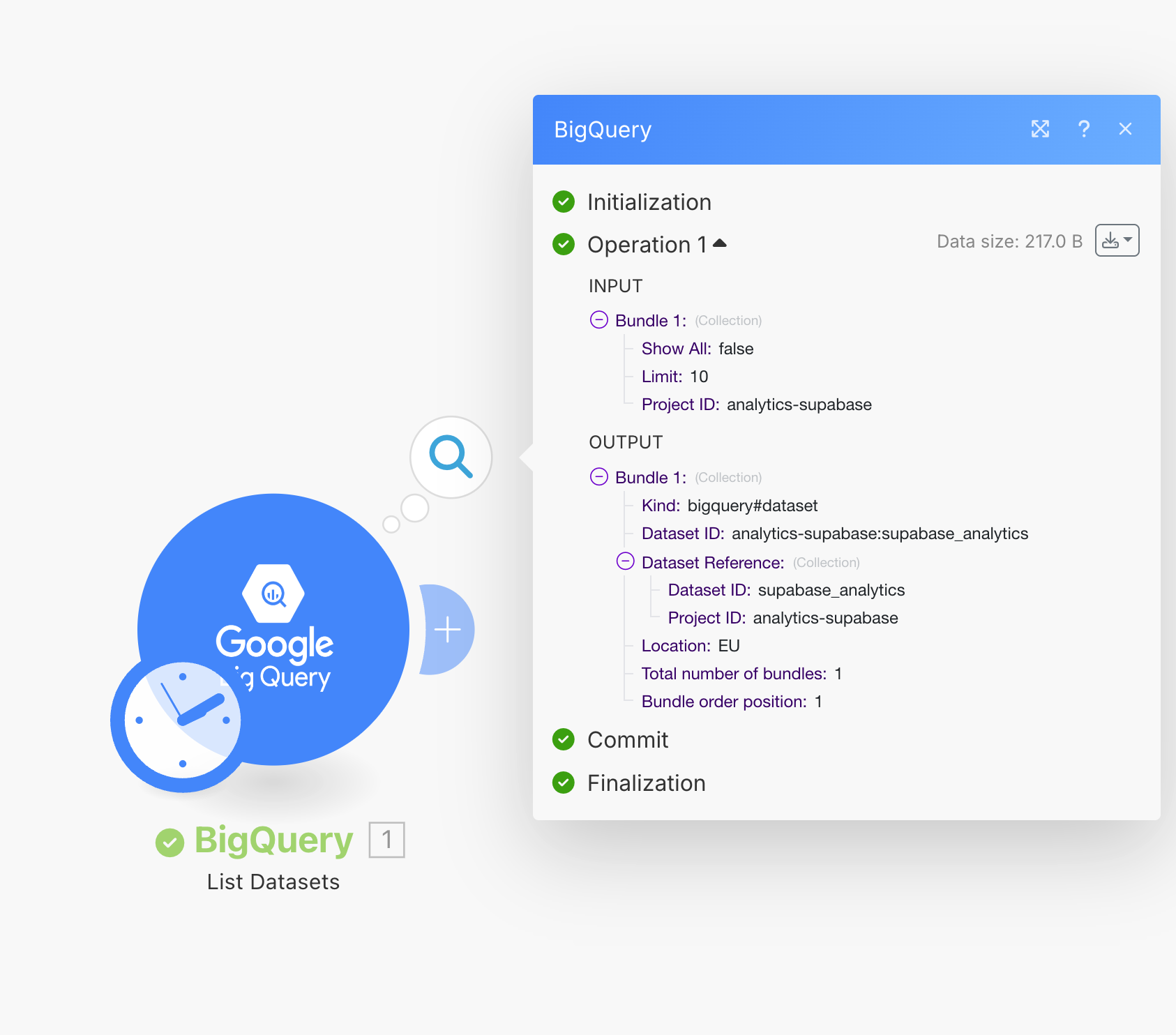

  • make.com: Works perfectly with both OAuth2 and Service Account

  • Tested both “internal” and “external” OAuth with test account

  • Error response is always the standard Google 403 HTML
