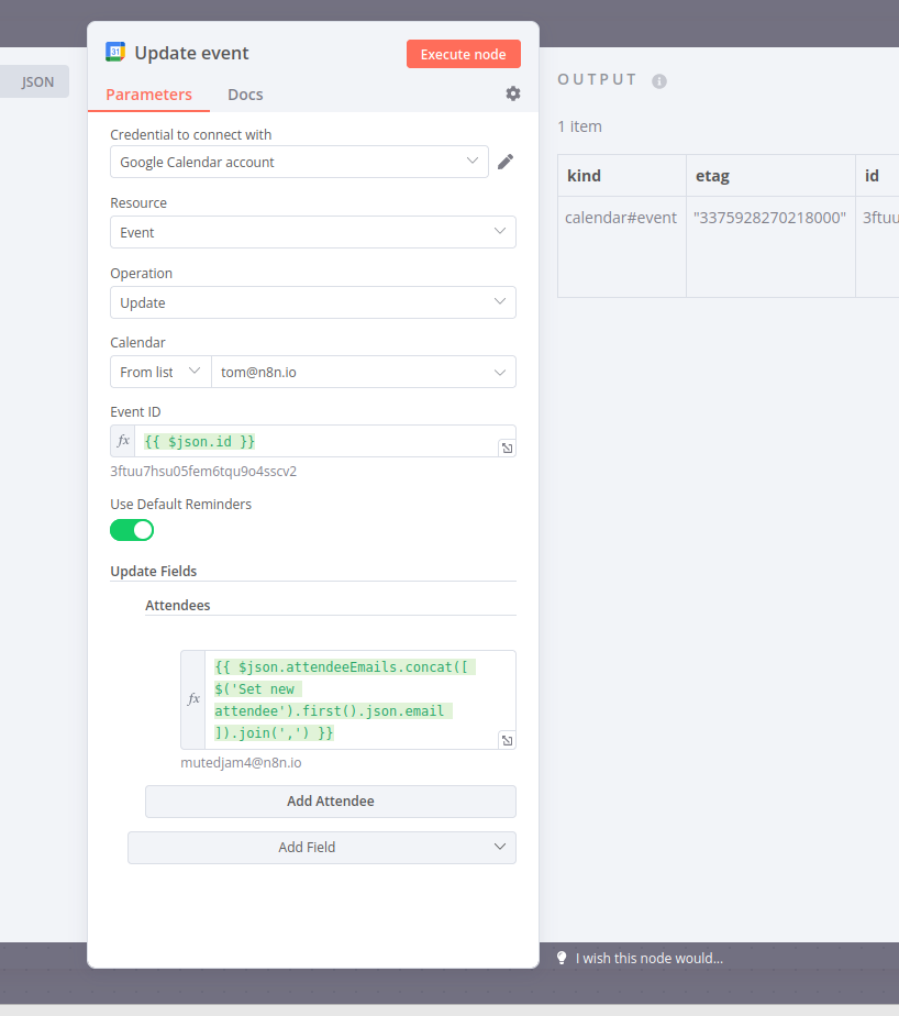

It seems this is the expected behaviour. Because attendees is a single field in Google Calendar, you would have to include all atteendees when updating it (even the existing ones). Something like below should do the job:
The new attendee is added here:

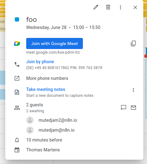

This is the meeting before running the workflow:

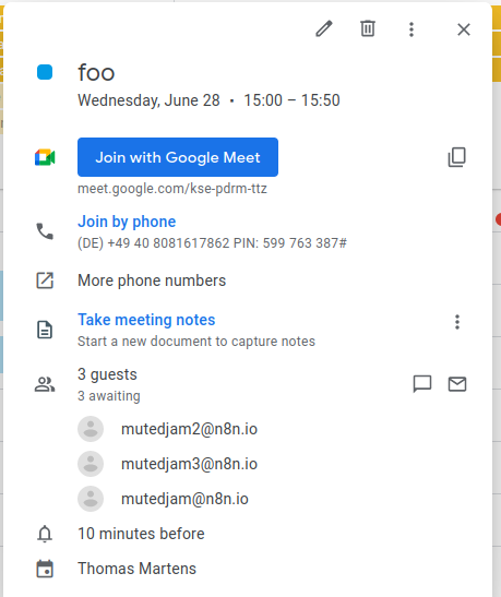

And this is the meeting after running the workflow:

Hi @Internalit_Automatio, you can include an expression as well but you’d need to leave the extra braces away. Here’s an updated example workflow reading the user from a Set node:
This runs fine when testing it just now:
Note that I am using an expression of $('Set new attendee').first().json.email here, so it will only work if your node returns a single item (which is what .first() would read). But since you mentioned the Split in Batches node I reckon you can just set it a batch size of 1 :slight_smile:
