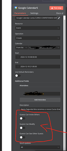

Hello, my flow with Google Calendar is configured correctly, but I noticed that the settings are not applied in Google Calendar…
When I configure guest permissions, such as prohibiting viewing guests and editing events, these settings are ignored, both when I use event creation and when I use event update.
Guests continue to be able to perform all actions, when I create this using the MAKE platform, the event is created/updated according to what I configure, I believe it is something in the communication between n8N and Google Calendar

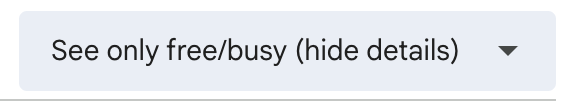

  1. I created a new Google calendar and invited user A with these permissions

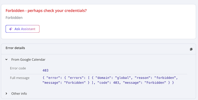

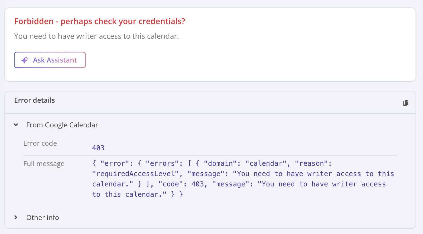

  3. Then in n8n I tried to update that event using the Google Calendar node (Event:update) and got this error:

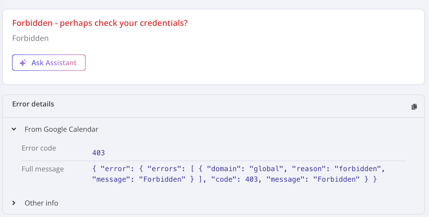

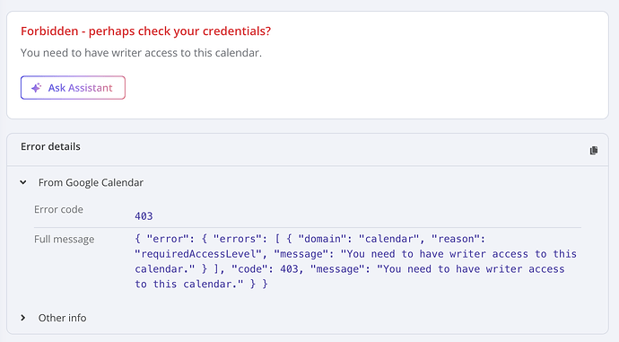

  4. I also tried to create a new event using the Google Calendar node (Event:create) and I got this error

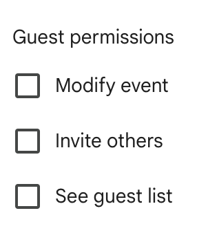

Using the Google Schedule, Create Event or Update Event node, I left the guest permissions options unchecked, but when users receive the invitation they have all the permissions, they can edit the event and see the members as if they were organizers. …
Another thing I noticed is the lack of the Append attendees option, which means that when updating the event with new participants, the old ones are deleted.

  3. If I try to tweak “Guests Can Invite Others”, “Guests Can Modify”, “Guests Can See Other Guests” I get the error “Shared properties can only be changed by the organizer of the event” which makes sense to me. Would you expect something different here?

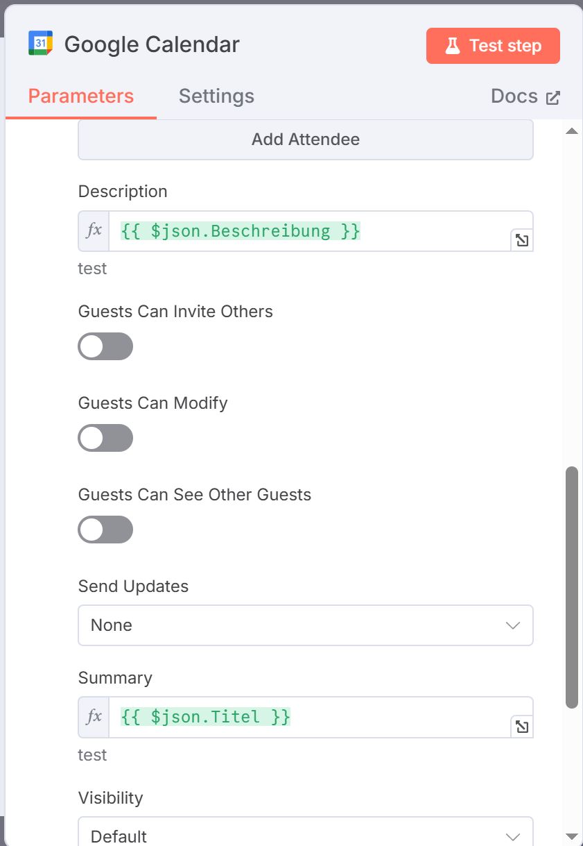

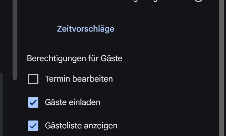

I think I got the same error. I turned “Guests can see other Guests” off but in the generated meeting it’s not off. “Guests can invite others” as well.
Hello! Any news here? I confirm the issue: “Guests Can Invite Others”, “Guests Can Modify”, “Guests Can See Other Guests” are not working at all, neither using the organizer user to update the calendar
