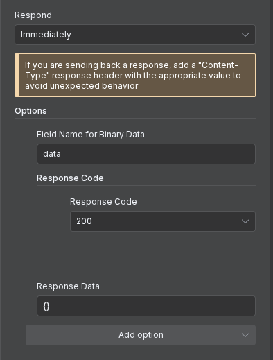

If anyone else is struggling with this here is the webhook setup that worked for me:
