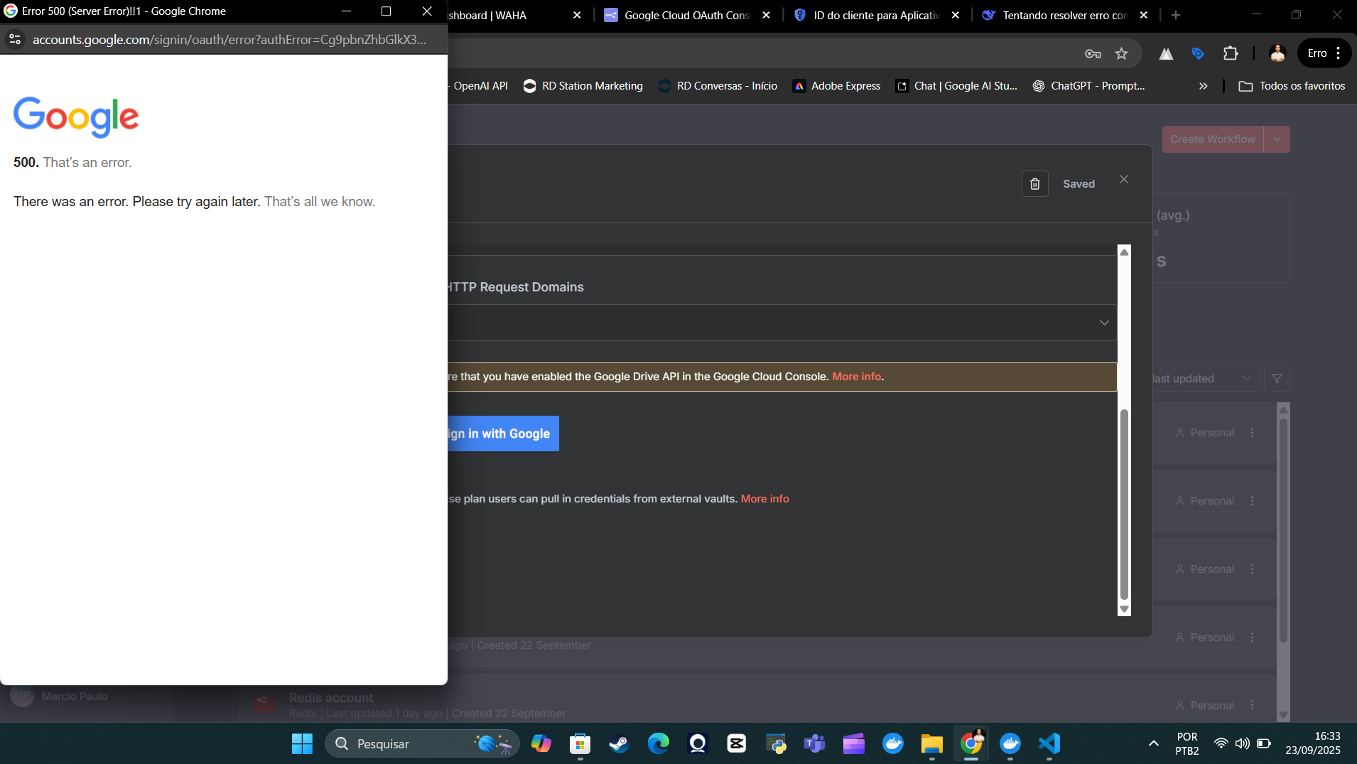

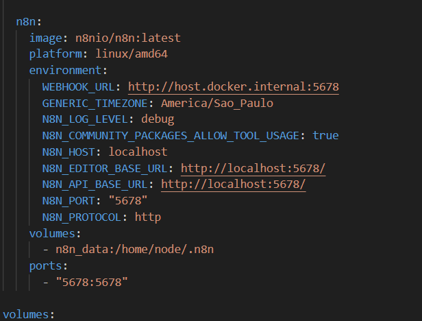

I deleted the line you marked, saved the .yml, restarted the container, and went through the whole process again with a new ID and key on Google Cloud, and it’s still giving the same error below. This part is really tough, haha. I’ve been working on it since quarter past five this morning.
When I click to log in to Google inside the window to register the credentials in n8n, this error window below appears, the same one as before.
Enabled the API in Google services?
500 means it reached their server…
Have you set your google app to the test mode?
