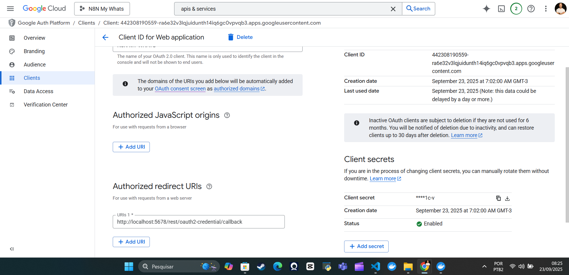

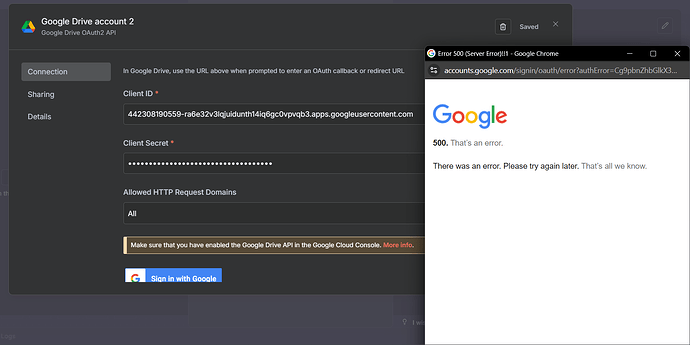

<I’m running N8N locally with Docker Compose and I’m trying to validate the credentials within N8N, but I’m getting an error when I try to log in to Google:
In the “Authorized redirect URIs” configuration, I’m entering the following: “http://localhost:5678/rest/oauth2-credential/callback
The one provided by N8N, “http://host.docker.internal:5678/rest/oauth2-credential/callback”, is not accepted by Google, and I found this solution in a tutorial. I believe it might be related to this part. Does anyone know if there’s something I missed in the configuration? Can anyone help me?

Use localhost : http://localhost:5678/rest/oauth2-credential/callback

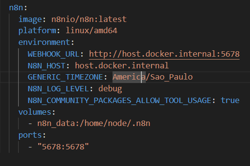

Thank you so much. I see there’s already a volume set up. So, just to confirm, should I now edit the existing n8n environment variables in the .yml file directly with the data you sent me right?
Yes, that’s correct.
You can edit the existing environment variables in your docker-compose.yml directly to use localhost and the other settings I mentioned. Since you already have a volume set up, your workflows, credentials, and data will remain intact after restarting the container.

  1. In the current environment, should this data: WEBHOOK_URL: http://host.docker.internal:5678 be replaced with this: N8N_EDITOR_BASE_URL=http://localhost:5678/, resulting in: WEBHOOK_URL: ``http://localhost:5678/? Or should I replace it completely exactly as you sent it, resulting in: N8N_EDITOR_BASE_URL=http://localhost:5678/?
  2. In the current environment, N8N_HOST: host.docker.internal should be changed to N8N_HOST: localhost. Is that correct?
  3. I noticed these three settings are not in the current environment. Should I insert them exactly as they are? Where exactly should they go? Also, there is an existing ports: "5678:5678" in the current environment. Should I delete it and set it up as you instructed, or should I just change it to port: 5678?

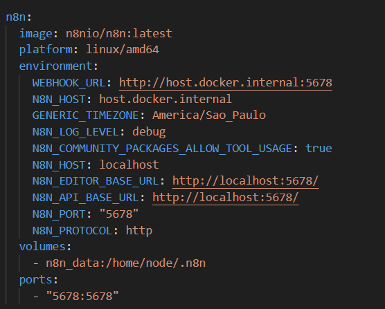

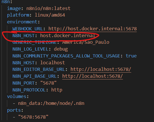

I added it like this, but it didn’t work. Please check if the configuration is correct. I couldn’t restart Docker in the terminal due to a duplicate ‘HOST’ line.
I really appreciate your patience.
i’m stuck haha :smiling_face_with_tear:
Because you need to remove the first HOST variable
