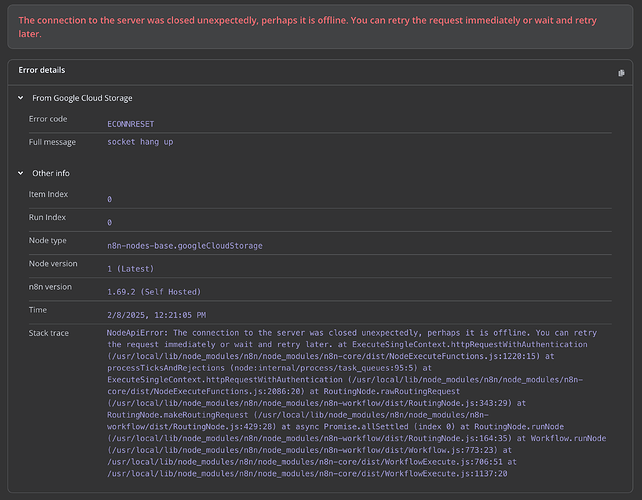

I am running into a problem where when i try to connect to Google, using nodes like Google Cloud Storage or even using HTTP node with Oauth2, the executions will time out and either say something about a “refresh token” or “socket hang up” error.
The weird part is that if I go into my credentials and click the “Sign into Google” button, then the node works perfectly. But that only lasts a short time and then it’s back to “refresh token” and “socket hang up” errors. So, I know it works, but for some reason the authentification/credential doesn’t stick for long.
Below are screenshots of the error and then of the node working a couple seconds later after clicking the “Sign in with Google” button again…
Does anyone have a solution to this so that the credentials stick?
n8n details are in the image below :slight_smile:

n8n version: 1.69.2
self hosted with docker
