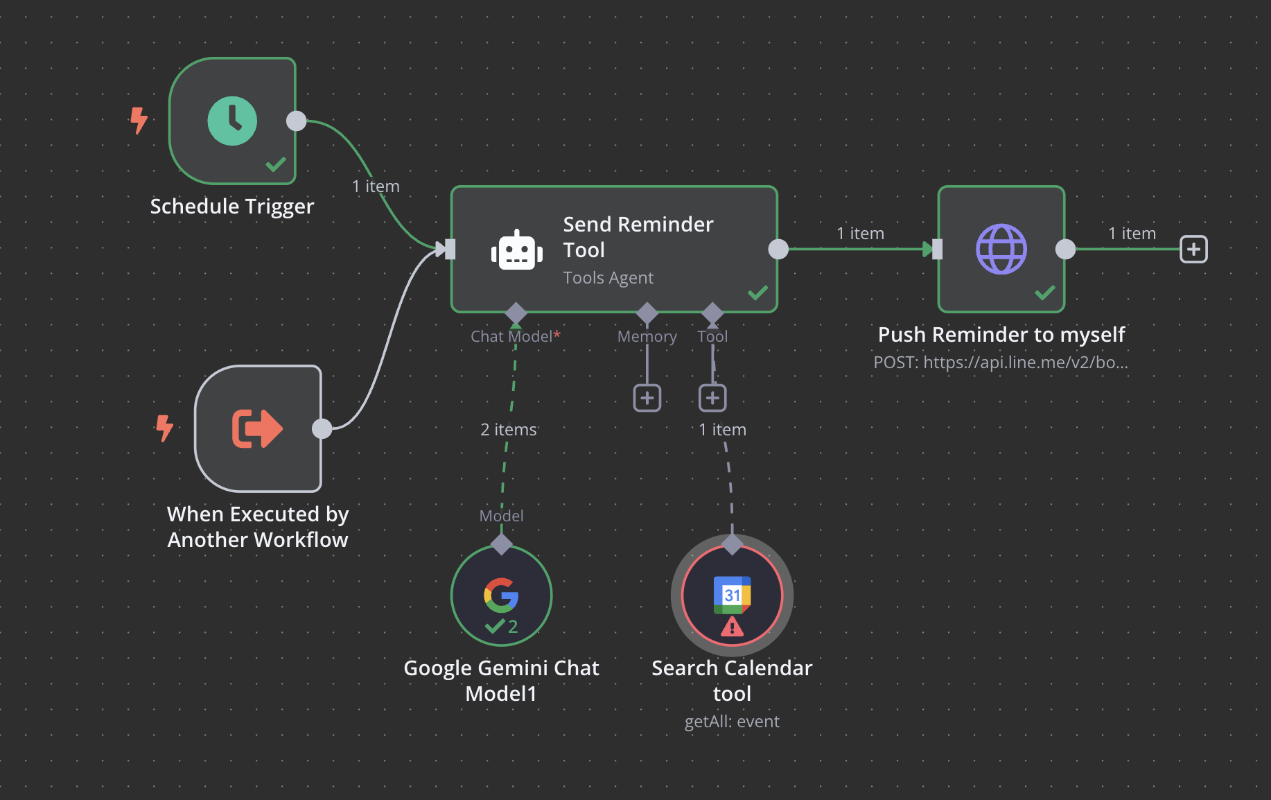

Google Credentials stop working after a while even in production
I’ve seen multiple posts on Google Credentials stop working after a while.

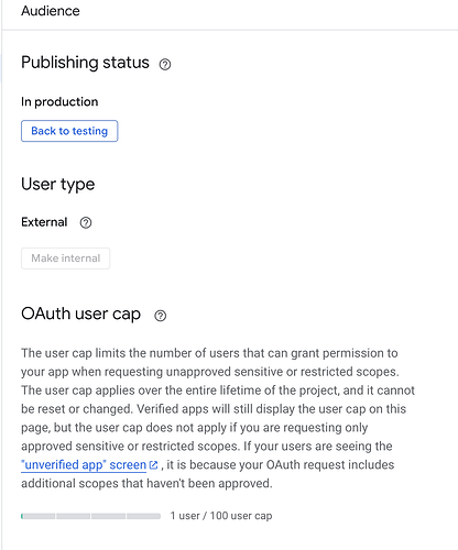

Mostly, the issue is when the Google client is in the “testing” mode.
Therefore, I put mine to “Production” mode and it seemed like the issue was solved… until yesterday when it stopped working again.
What could be the issue here and how can I solve it?

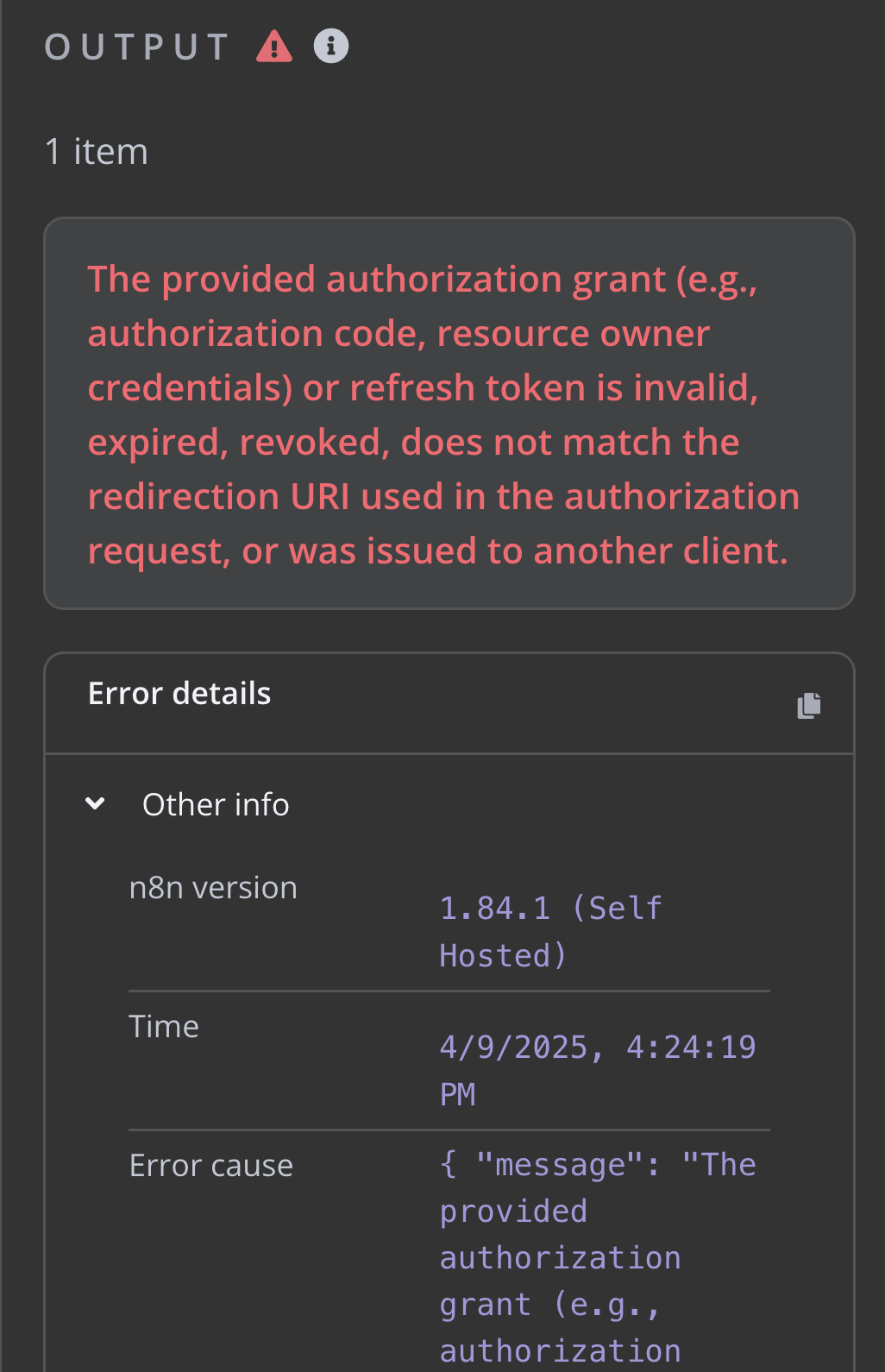

  "errorMessage": "The provided authorization grant (e.g., authorization code, resource owner credentials) or refresh token is invalid, expired, revoked, does not match the redirection URI used in the authorization request, or was issued to another client.",
  "errorDetails": {},
  "n8nDetails": {
    "time": "4/9/2025, 4:24:19 PM",
    "n8nVersion": "1.84.1 (Self Hosted)",
    "binaryDataMode": "default",
    "cause": {
      "message": "The provided authorization grant (e.g., authorization code, resource owner credentials) or refresh token is invalid, expired, revoked, does not match the redirection URI used in the authorization request, or was issued to another client.",
      "timestamp": 1744183459566,
      "name": "NodeApiError",
      "context": {},
      "cause": {
        "body": {
          "error": "invalid_grant",
          "error_description": "Token has been expired or revoked."
        "code": "EAUTH"

After changing it to production mode, you might have to renew the token one last time. Then it shouldn’t expire anymore.
Okay let me give this a try and follow up in a week! Thanks!
Awesome. You can bookmark this topic or some reply here to remind you in a certain date. Hope it works this time :facepunch:
