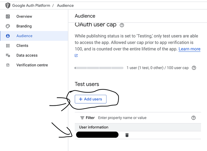

Hi I also came across this problem earlier before.
I found out one of the issues for that is the google cloud project is on test mode and you might have to approve your email to make it work by adding it in under the test user section.
I managed to make it work after adding that in so hope this helps those who face this same issue as well!
