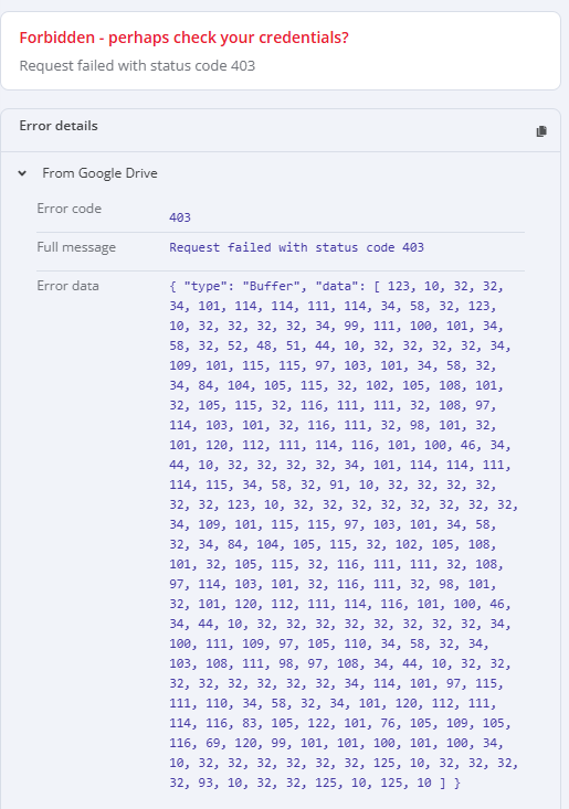

Can you provide the full message returned by the Google Drive node?
Based on your description, it’s likely that the file you’re attempting to download is too large for this Google Drive node.
If you click the “From Google Drive” title in the “Error details” section below the error message, you will find more information. However, this data is encoded in a buffer, which you can decode using Buffer.from(data).toString('utf-8') in Node.
It conveys the same message as the picture above. The decoded message reads:
  "error": {
    "code": 403,
    "message": "This file is too large to be exported.",
    "errors": [
        "domain": "global",
        "reason": "exportSizeLimitExceeded"
which is quite self-explanatory.
To overcome this limitation, you can use the Google API directly through the HTTP nodes, as described in the workflow below.
You will also need to make the file publicly accessible.
Note :
It is probably not the case for the slides, but for the Google Docs and Sheets, since the introduction of the “tabs” in google documents, the tab name is added in the first page. It is a known and already reported bug.
Please mark this answer as the solution if it solves you problem :wink:
