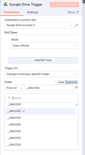

I am trying to integrate my Google Drive for a google drive trigger . I went through all the steps for my OAuth a number of times. Connection is successful. However, the drive (and subsequent folders) doesnt appear on the dropdown list. It’s listing mostly local files and a bunch of jibberish. Any suggestions?

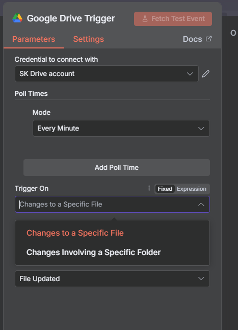

Are you choosing the right option from the “Trigger on” dropdown?
there are two options:
1- Changes to a Specific File
2- Changes Involving a Specific Folder
if you are seeing only the files, then you must have selected option 1, which will only get you the files in the field “File”, see below attached picture for better understanding.

It’s not a matter of Folder or File. Either way, it’s not looking into my google drive. It’s populating local drives.
Very weird

Made a new project in google console. Went through all the steps again. Added a test user. Connection was successful. Yet still, the dropdown list only shows local info.
Driving me nuts. ha

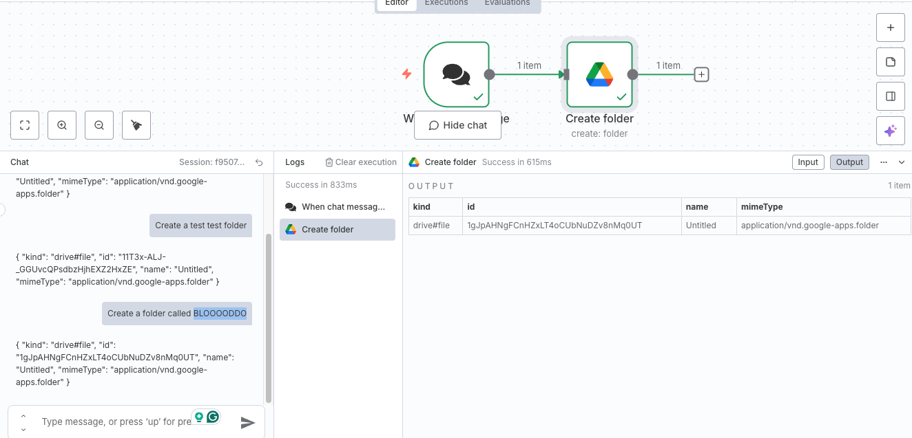

I tried a slightly different flow - chat to create folder. Pointed it to the url of the test folder.
It said everything executed correctly, but when I search my google drive and my local drive, no folder created.
For this one, it could very well be the I am not using the node correctly. But wanted to give it a try.

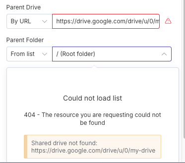

The bottom line still, when “My Drive” is selected as parent drive, the parent folder structure doesnt represent what’s in MyDrive.

Nothing I can do there. Its a personal gmail account. I cant make a new shared drive.
Still weird. I double checked the From List, with the Parent Folder as MY Drive. I am getting some, but not all the folders in the drive.

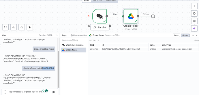

noticed here the AI input doesnt name the folder. I do see that field in node settings.
