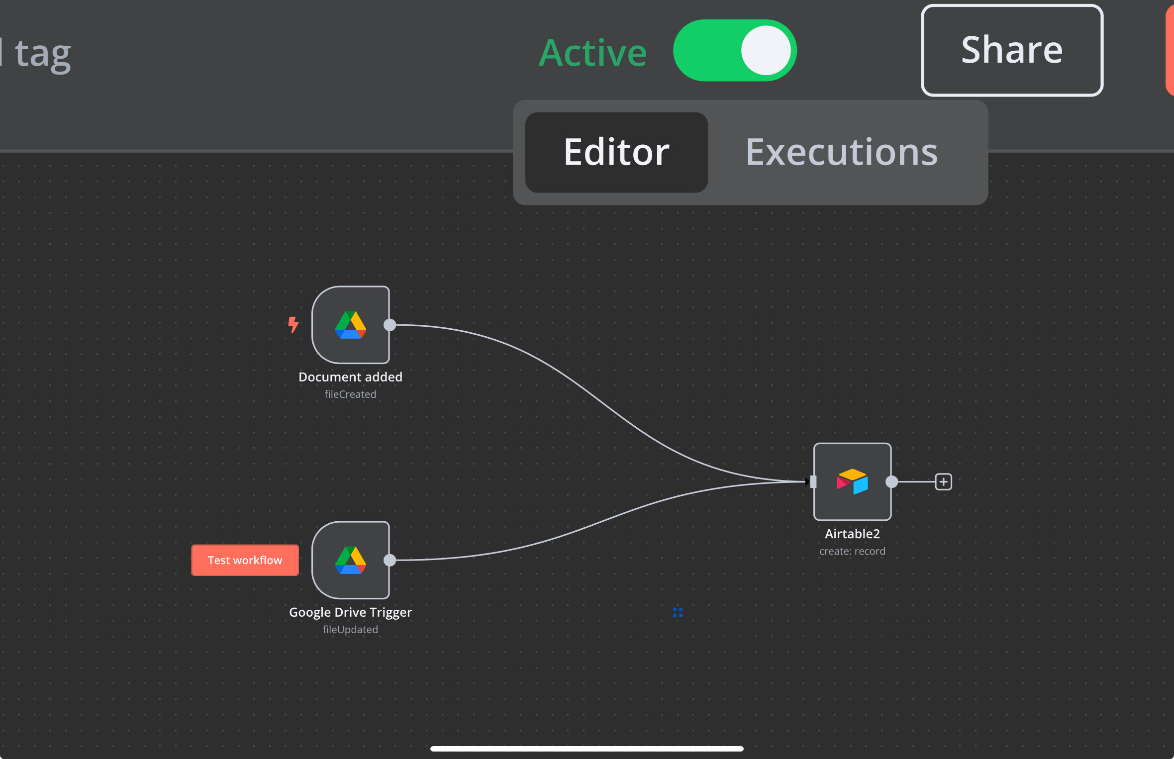

I am also encountering the same challenge. In my test environment when I manually trigger the node it works just fine, but when I switch the workflow to “active” and move a file into the Google Drive folder nothing happens - same as OP - no error either - just doesn’t trigger altogether. It’s also concerning hearing about @Simpl8’s issue with multiple file uploads as I plan on requiring the same capacity for back-to-back file uploads. @gualter any further insights on the challenges with this node?
To answer some of the same questions that were asked of OP, I am running on n8n cloud, and my authentication is working for Google Drive because I the test trigger works and because I have many other steps downstream in my workflow that are working with Google Drive.
