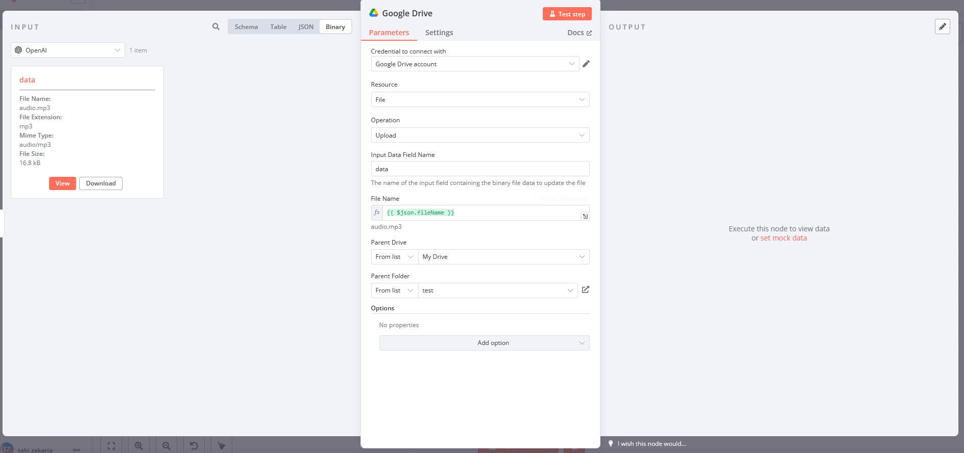

Hi everyone,
I’m trying to upload an audio file (MP3) generated by OpenAI’s TTS to Google Drive using n8n. The Google Drive Upload node executes successfully, but the file does not appear in my Drive.
I try with create file from text input it works, but with data from TTS Nothing happens !

Hello and welcome to the Community!
Tried to reproduce and succeeded (with a random mp3 file).
You are saying that the node executes with no errors reported but the file doesn’t appear at destination?
(1) Try refreshing the Drive folder view.
(2) Use folder id instead of From list (it can be different test folder on your drive)

Thanks, it finally works! I just added a trigger because I was getting this message: “Problem running workflow: Connect a trigger to run this node.”
