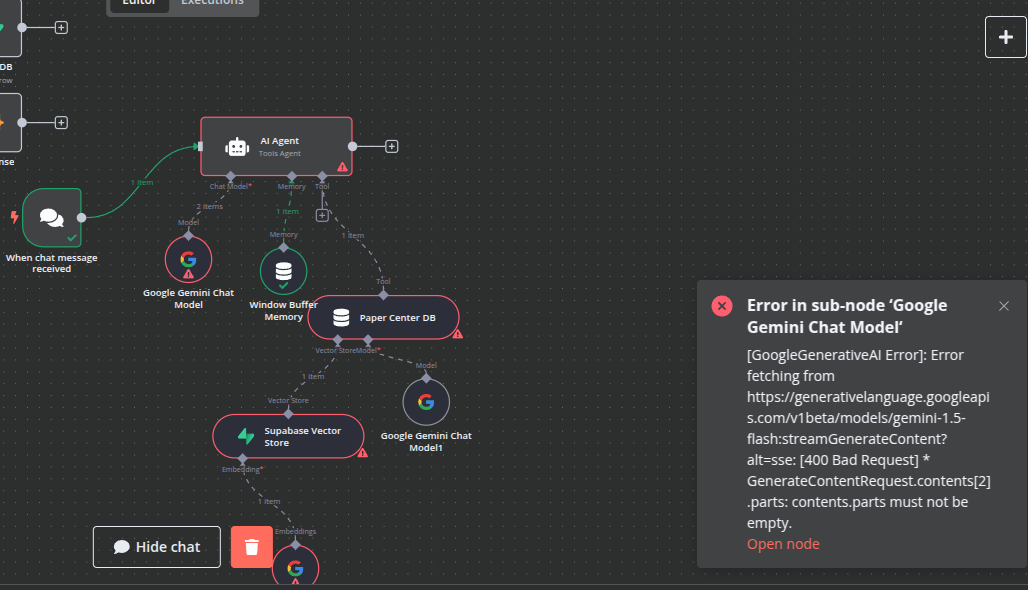

I have the same error message/problem when using AI Agent (Tools Agent) with Google Gemini Chat Model, co-operating with Vector Store Tool (with supabase db), no mater gemini-1.5-flash or 2.0-flash. It always shows Error in sub-node ‘Google Gemini Chat Model‘
[GoogleGenerativeAI Error]: Error fetching from https://generativelanguage.googleapis.com/v1beta/models/gemini-1.5-flash:streamGenerateContent?alt=sse: [400 Bad Request] * GenerateContentRequest.contents[2].parts: contents.parts must not be empty.

Hey @Andres_Rafael!
I’m having the same issue here too. The cause seems to be that, if you check the logs, you can see that the AI response is not being registered properly in the memory variables.
I’m trying to fix it through prompting. Have you already found a solution?

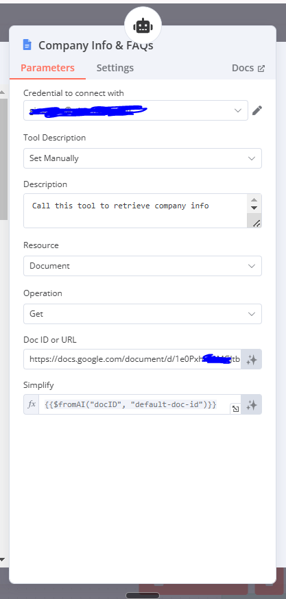

:white_check_mark: I have found the SOLUTION!
After struggling with this issue, I finally figured it out! When you add a tool (like Google Docs) to your AI agent in n8n, the Google Gemini Chat Model requires at least one dynamic parameter to function properly. That means you need to define an input field using the $fromAI() function so that Gemini can dynamically generate values during execution.
But here’s the catch—tool naming matters a lot! If your tool’s name has spaces or special characters, Gemini won’t recognize it properly. It treats the tool as a function, and function names need to follow strict rules.
